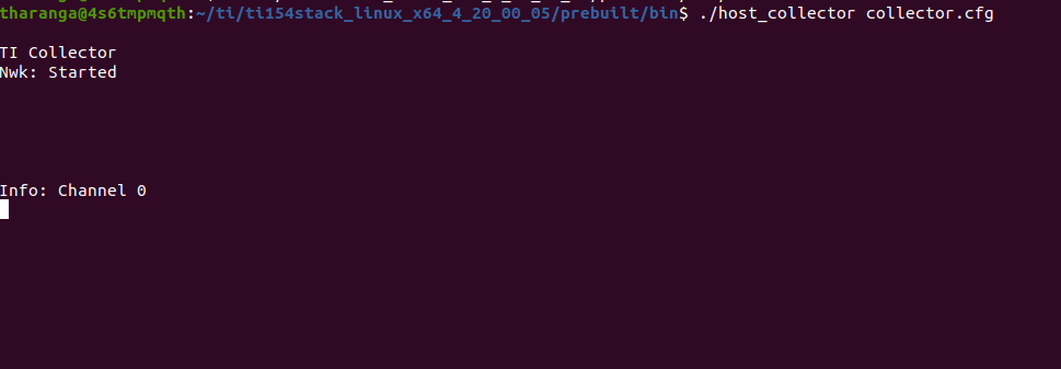

But all I see is,
:~/ti/ti154stack_linux_x64_4_20_00_05/example/collector$ ./host_collector collector.cfg
TI Collector
Nwk: Started
   0.079: Transport: 3
   0.079:   Product: 1
   0.079:     Major: 2
   0.079:     Minor: 2
   0.080:     Maint: 0
Info: Channel 0
The terminal window does not accept any key entries. Nor can I see the "cmd:" prompt.
What am I missing here? Could't find much from E2E's old posts too.
PS: There is now way I could change the CFLAGS += -DIS_HEADLESS using the Prebuilt binaries even though this SLA Lab ignores mentioning it.

  • Hi ,
    Digging a bit further down in the Collector Source code, I realized the following.
    Execution flow is as like below.
    In collector_thread() --> Collector_process() --> Csf_processEvents()
    Here,
    if IS_HEADLESS is commented on the Makefile,
    Goes to getConsoleCmd().
    In getConsoleCmd I obsereved that,
    getchar() always returns -1 upon execution of host_collector. Thereafter, the key strokes are not accepted either.
    Thus, this line is never printed.
    Board_Lcd_printf(DisplayLine_cmd, "cmd: %s", cmd);
    But,
     if I do this on the terminal,
    echo "o" | ./host_collector
    it accepts the command 'o' and prints,
    Info: PermitJoin-ON
    Why does the terminal key inputs are not detected here? Please let me know if you need further info. Still on Ununtu 20.04
  • There will be a fix for this on the next sdk update, which is why I was asking about v 18.04 (the version that our documentation states our SDK works with).
    Nevertheless, it seems like there is an issue with noncanonical input mode using getchar. Whenever getchar is called in noncanonical mode without anything buffered in stdin, it returns EOF when it should return 0. This means subsequent calls to getchar get locked to returning EOF no matter if there is buffered stdin input.
    This can be fixed by forcing canonical mode, but that results in not being able to see input character by character.
    another quick fix can be to add:
        else
            clearerr(stdin);
    after the if statement that is after getchar().

  • Hi ,
    Adding the else {} block didn't seem to work well. As you said not being able to see multiple input characters on the same line can be confusing.
    Thus one of my colleagues came up with this workaround, which seem to work well. I am posting it here for everyones' benefit.
    Instead of reading the input command from the Terminal, is is read from a file.
