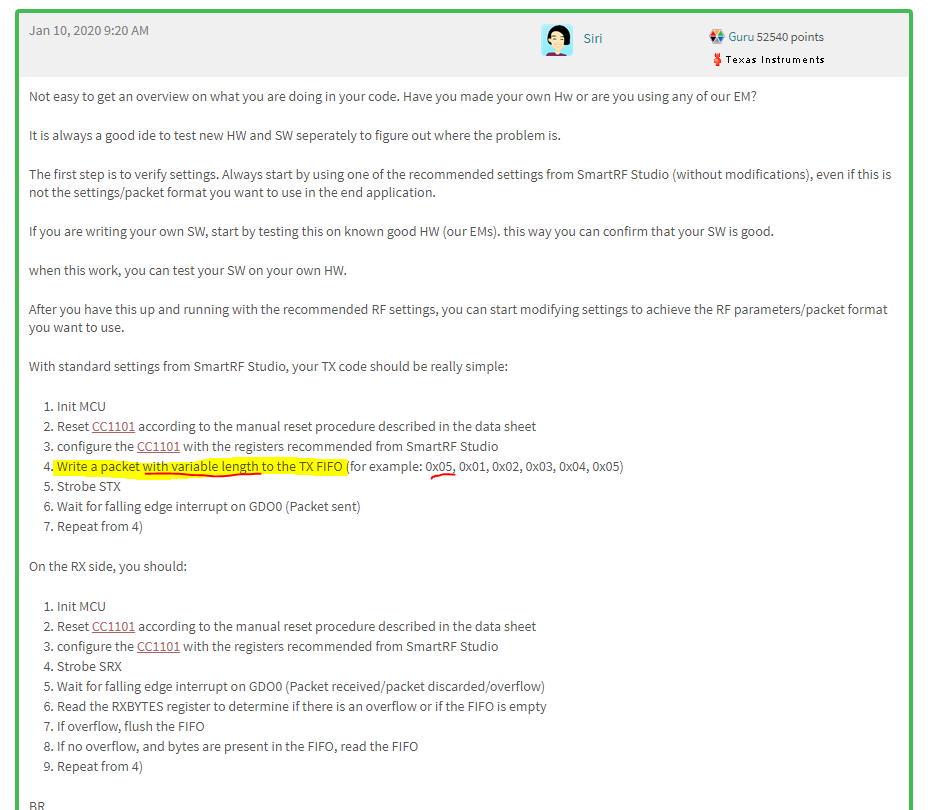

Hi;
I do not want to send the lenght of my buffer. I just want to send exactly my buffer but on my code if ı do not send a size of my buffer first  and even if I change the inside of my buffer, it continues to send old data. Even  PKTCTRL0  (Packet automation control) is "0x05",it is meaning Infinite packet length mode. So ı do not need to send a size of buffer. But my problem is lets say ı am sending a fener[26] buffer and ı delete the send a size of buffer on  cc1101_send_packet function and change the sending data lets say ı made packet[26]  and reload program again but it still send old(fener[26]) data. but when ı open the sending size function in cc1101_send_packet function

  • Hi
    I do not understand your comment:
    "Even  PKTCTRL0  (Packet automation control) is "0x05",it is meaning Infinite packet length mode."
    PKTCTRL0 = 0x05 does not mean infinite packet length mode but means Variable packet length mode (Packet length configured by the first byte after sync word)
    In this case the radio will interpret the first byte you write to the TXFIFO as the length byte, and it will try to send as many bytes as indicated by the length.
    If you use variable packet length mode, and write 0x01, 0x02, 0x03, 0x04, 0x05 to the TX FIFO, the 0x01 will be interpret as the length, and only 0x01, and 0x02 will be sent (0x03, 0x04, 0x05 will be left in the FIFO, and the next time you try to send something (if you are not flushing the FIFO), the 0x03 is the first byte in the FIFO and it will be the length.
    If you only want to transmit 0x01, 0x02, 0x03, 0x04, 0x05, you need to use Fixed packet length mode (PKTCTRL0 = 0x04), and set PKTLEN = 5 (number of bytes you want to send)
    Siri
  •  I do not want to send variable length. I just want to send a my data.
  • If you do not want to send the length, you do what I just explained:
    "If you only want to transmit 0x01, 0x02, 0x03, 0x04, 0x05, you need to use Fixed packet length mode (PKTCTRL0 = 0x04), and set PKTLEN = 5 (number of bytes you want to send)"
    Write the data you want to send to the TX FIFO, and set PKTLEN to the number of bytes you want to send.
    If you write 26 bytes to the FIFO, set PKTLEN = 26 and make sure PKTCTRL0 = 0x04.
    Siri

  • 1) Can ı read what ı wrote in TXFIFO, i mean how can I read TXFIFO.
    2) how can ı clear TXFIFO. is there any command for this
  • 1) You cannot read the TXFIFO. After you write to it, you can read the status register TXBYTES, to see how many bytes are in the FIFO.
    2) The FIFO can be cleared by flushing it.
    In your code try to:
    Flush the TX FIFO (SFTX)
    Write your packet to the TXFIFO (26 bytes)
    Strobe STX
    On the RX side:
    Flush RX FIFO (SFRX)
    Strobe SRX
    Wait for packet to be received
    Read the packet (There should now be 28 bytes in your RX FIFO, 29 payload bytes and 2 status bytes).
    Make sure that both the transmitter and receiver are configured for fixed packet length mode and that the packet length is set to 26.
    Siri
