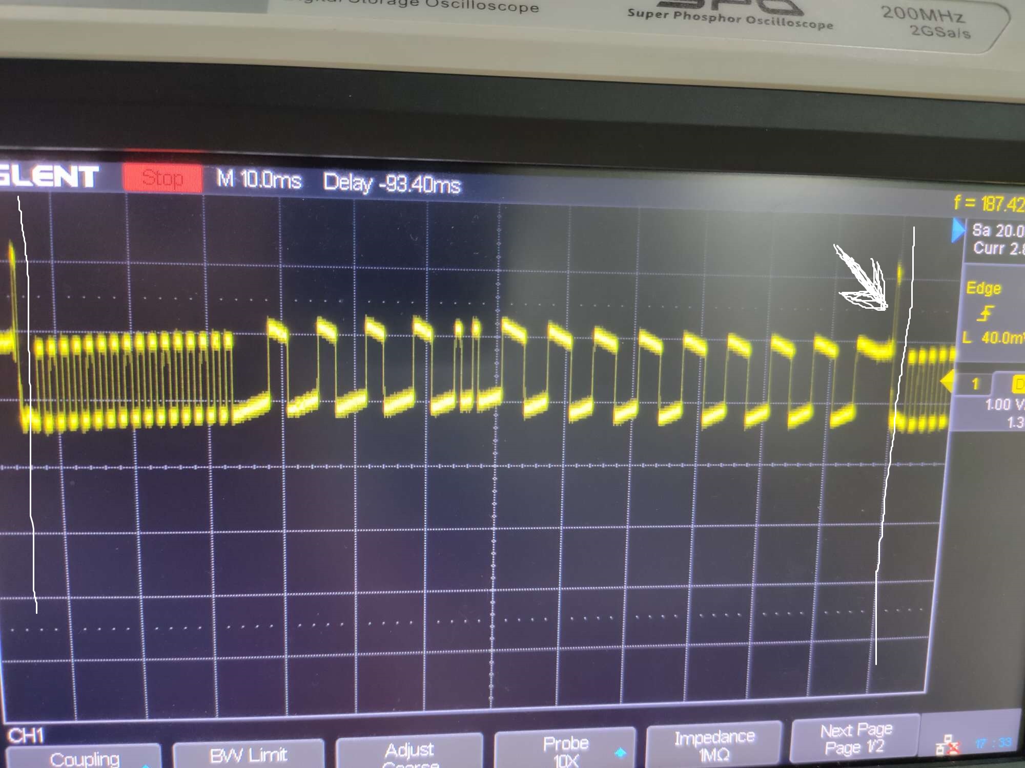

CC1120: Noise in packet RF send.
Part Number: CC1120
Hi TI supporters!
I use cc1120 to transmit data:
-4bytes Preamble(0xAA) + 4 bytes sync(0x07) + payload(10byte)
Payload is:
        tx_rf_buff[0] = 0x09;
	tx_rf_buff[1] = 0x0F;	// serial number 1-6
	tx_rf_buff[2] = 0x0F;
	tx_rf_buff[3] = 0x0F;
	tx_rf_buff[4] = 0x0F;
	tx_rf_buff[5] = 0x0F;
	tx_rf_buff[6] = 0x0F;
	tx_rf_buff[7] = 0x0F;	// Mode 00 - PTT, 01 - sensor
	tx_rf_buff[8] = 0x0F;	// Battery data 00-FF
	tx_rf_buff[9] = 0x0F;
When I send this packet, end of each packet have a noise pulse. I don't know what is this. This noise make frequency diviation is increase.
Can you help me fix this problem?
Thank you!
Vu.
    Which hardware are you measuring this on ?
       Richard
  • Hi Richard!
    I'm running on my custom hardware.
    Vu.
    I set TXOFF_MODE = 10b (TX).
    It look like TX is off when packet TX finished successfully. In this moment, TX power is 0mW.
    When I change setting PA_CFG(related  PA ramping) this noise pulse is change.
    Do you have any idea?
    Vu.

    Have you tested with TXOFF_MODE = 00b
    Have you tested with the default settings in SmartRF studio with the Generic 434 MHz, 1.2 kbps, 2-FSK, RX BW 25 kHz PHY ?
       Richard
