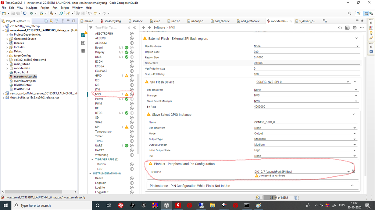

  • I'll look closer into why one API works and another causes issues. It looks like you are not using syscfg, does that mean you have disabled it?
  • I'm using CC13x2_26x2_sdk_3_30_00_03 SDK, it doesn't have syscfg.  Today I tested with SDK4.3, same issue with new SDK also
  • 3.30 has syscfg, this was the first version it was present on.
    But, for the test you did with SDK4.30, could you post the resulting ti_drivers_config.c file? I'm also waiting for the schematic as a PM.
    sorry, i used CC13x2_26x2_sdk_3_20_00_68 SDK.
    I sent schematic

  • I asked about the .c file, it looks like you have included the .h file

  • Have you set "Use Custom Board"? If not, syscfg will use the pins that are mapped to the falsh on the selected launchpad. Look under "TI Drivers" -> GPIO for where the CS for the flash is defined.
  • How have you set CS to DIO10? The only refrence I found was still tied to DIO20 which is used on the LP?
    I have attached screen shot of syscfg below. i highlighted in red color where i set CS pin.
    Have you monitored the SPI interface in the working and non working case to see what the delta is?
    sorry, im not getting this query
    Yes, i have set "Use custom Board".
  • Would you be able to send me the .syscfg file? Then I can import this in a project and see the resulting files. Note that in the original NVS project, the CS pin is set directly under GPIO driver, not under NVS.
