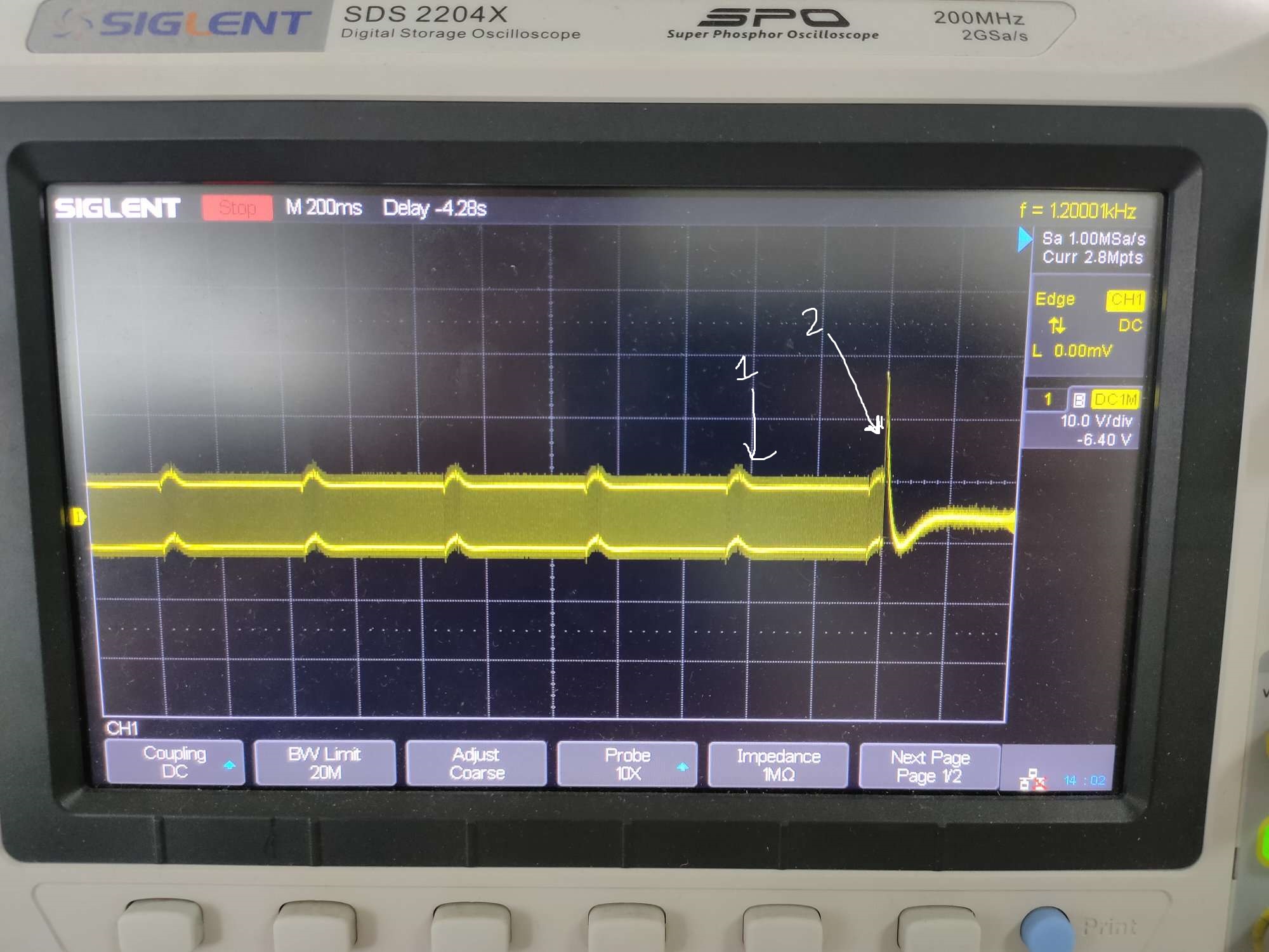

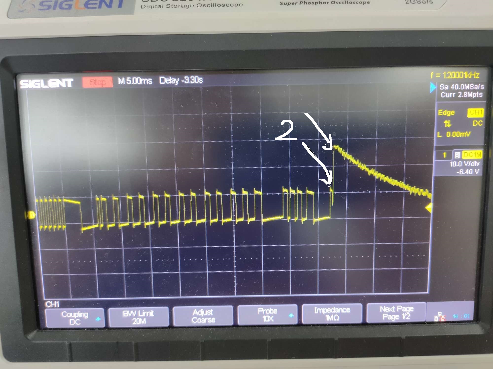

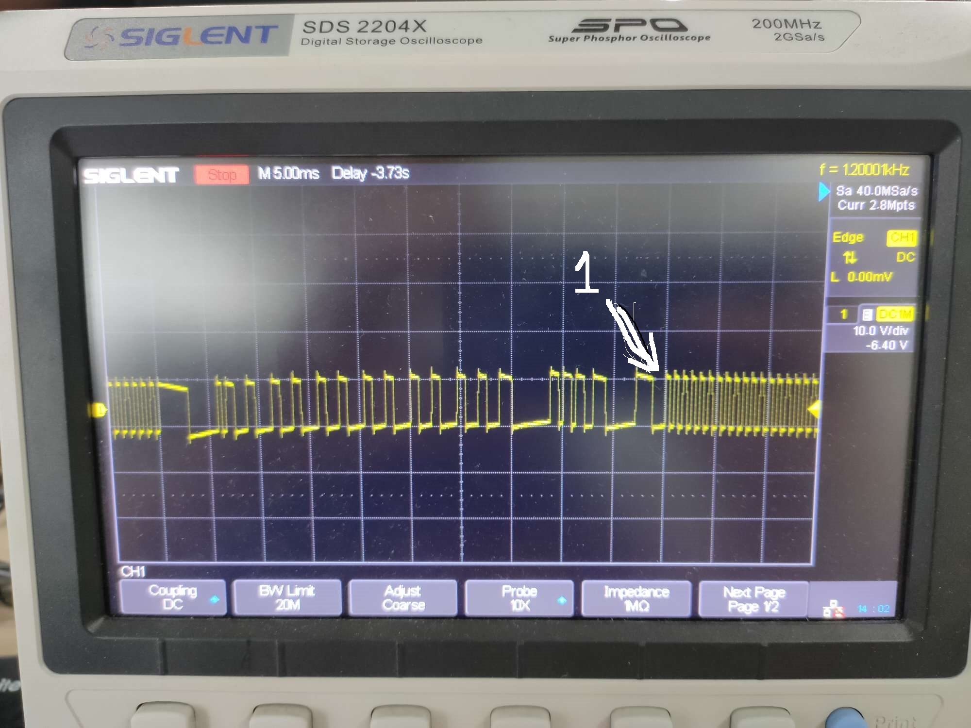

    The last byte wrong because TX side:
    As you can see, the last byte data when I send continuos( pointer 1) data OK, when the last byte data send => IDLDE then data will be wrong, noise is generate(pointer 2).
    Can you explain it?

    Now, I want to know the pulse noise at the last byte of packet.
    Thank you,
    Vu,
  • Have you seen issues caused by "noise"?
    The plots you have posted: What is the "y" axis, is it output power or deviation? Is the noise independent of the PA ramp settings?
  • Hi TER,
    It's output of AF level, about 2Vpp is output when AF LEVEL = 0 dB.
    When I change PA ramp setting, It wil be change.

  • RX: Not exactly sure what you mean. My understanding is that you have your DUT, you have no known input on the antenna port and you are not able to read a RSSI lower than -111 dBm? Do you have an antenna connected? In that case what you are seeing is the noise floor where you are located. You can see if that is the case by moving the DUT into a RF shield and see if the RSSI drops.
    TX: Not exactly sure what you mean here. First, Not sure what you mean by AF level and where exactly you do this measurement. Secondly, why do you do this measurement? We are never looking at the signal in the voltage domain.
  • RX: I have a Radio communcication tester, Tester connect to RX via coaxial cable.
    Then I set input power RX, When noise in RX, I'm not able to read RSSI lower than -111dBm.
    When I change channel RF, RSSI still -111dBm.
    TX: I think because it make RX receive packet wrong(at end of packet)
