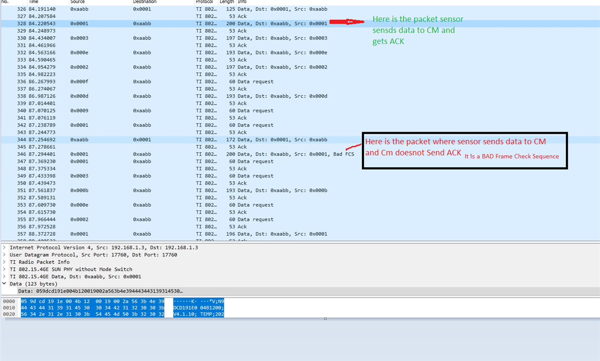

  • Hi Siri,
    I will send packet sniffer logs of association later, but presently I had encountered another issue, i.e., retry messages from sensor and collector not sending acknowledge t sensor. I had sniffer logs for this. Can you please check and confirm what are the things going over the air. Also, the association response does not send by the Collector maybe will come in the same category.
    Due to size constraint, I had removed hex data transferred from the sensor to the collector and some command data like the following

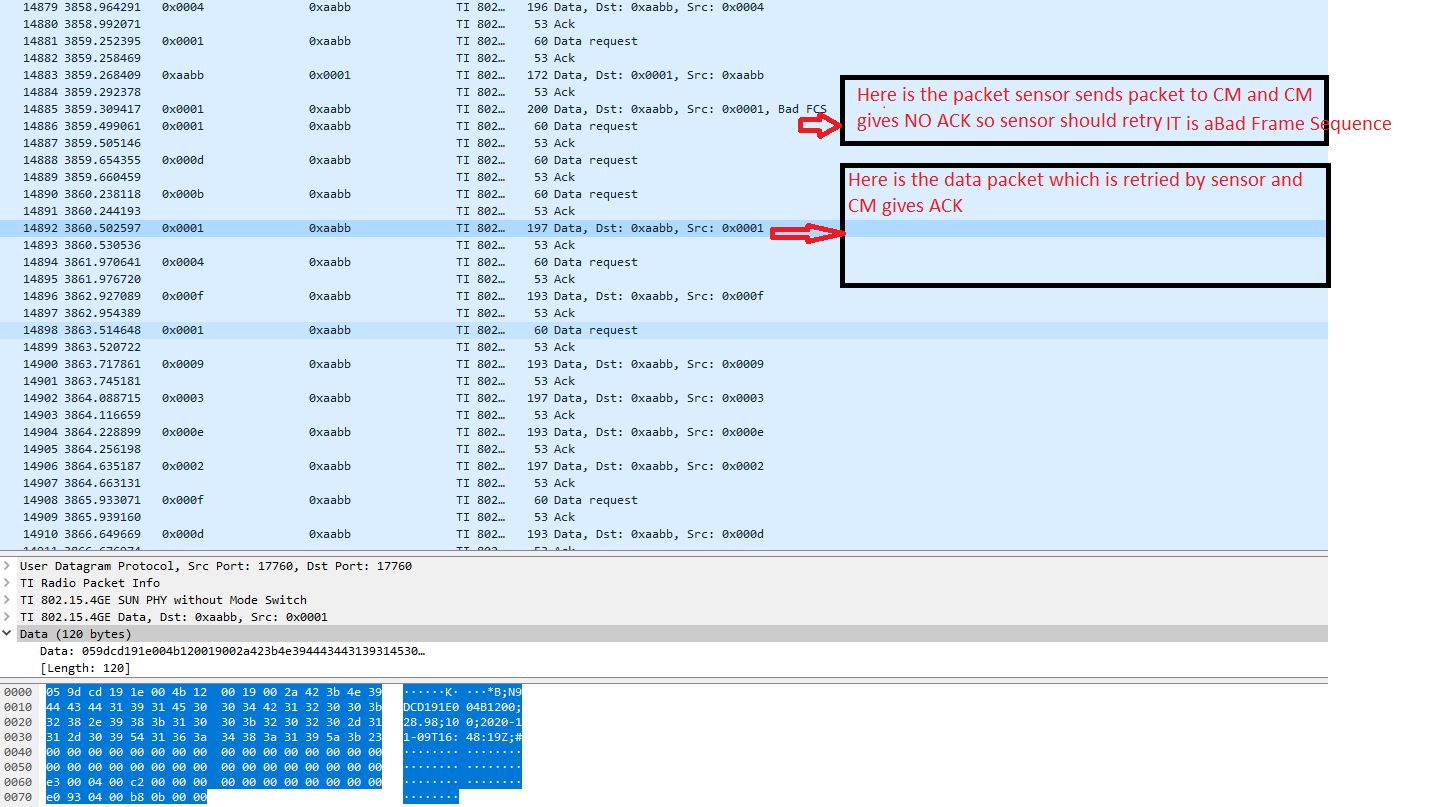

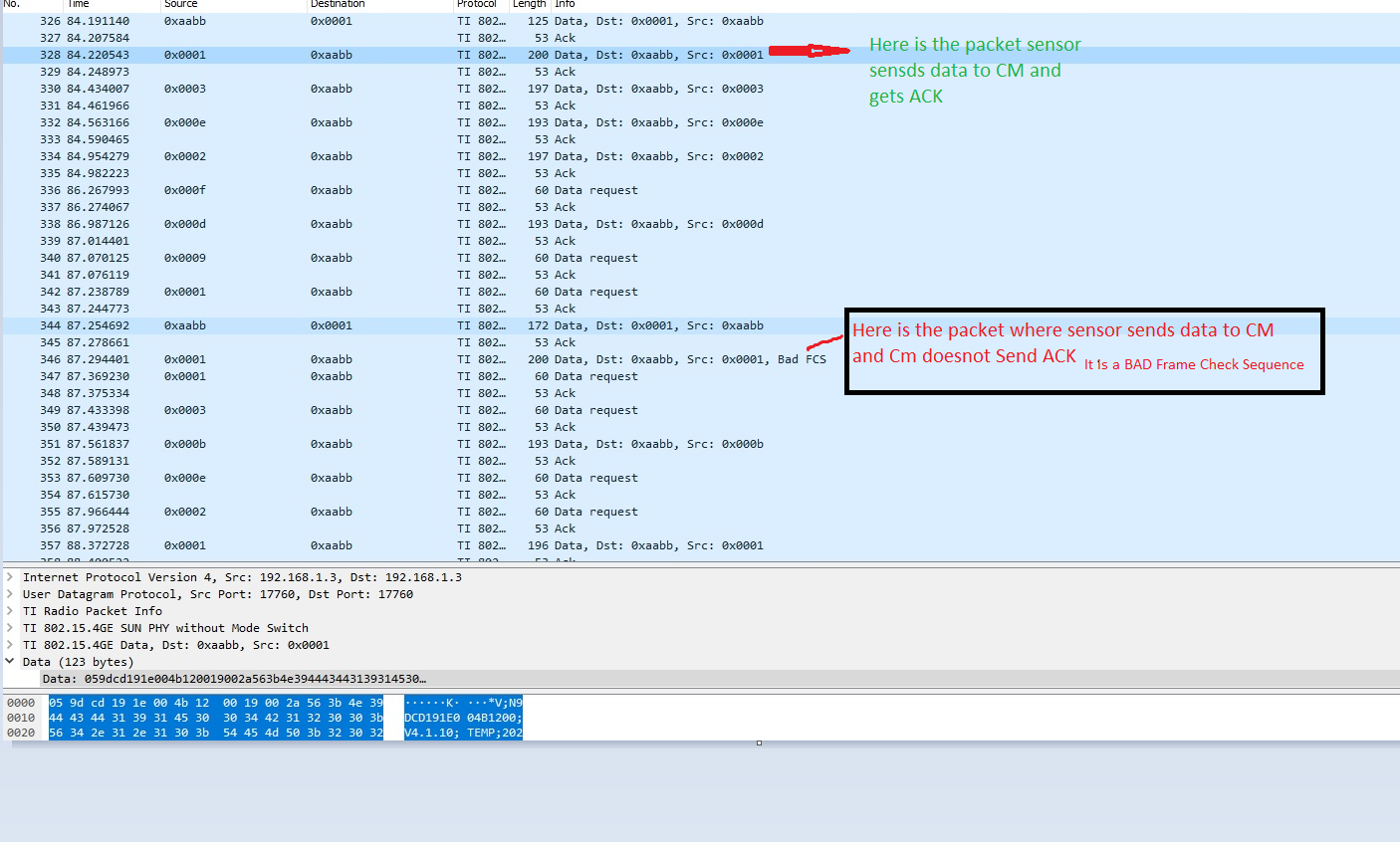

  • Hi Siri,
    There is one more query in the logs I have attached to the .png file which shows Bad FCS. Can I know the reason why this Bad FCS(Frame Check sequence) occurs?
    Also, note that the data is received by the collector without any duplicates even when the sensor retries two times when BAD FCS occurs.
