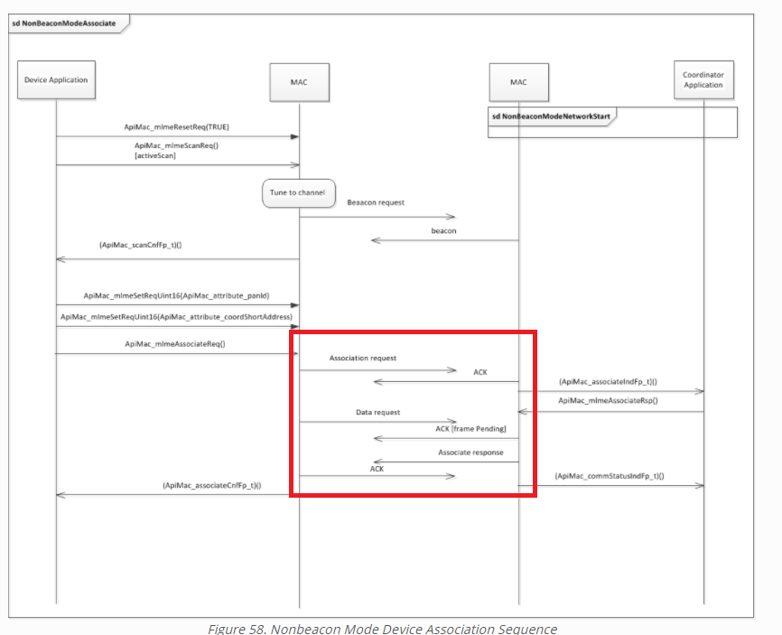

When associating a sensor (based on the example Sensor, cc1310) with the collector (based on the example collector, cc1352r1), the sensor in scan mode consumes a lot of power. Our system is very sensitive to long-term continuous consumption of high current, because the sensor operates on charged capacitors and external power supply is not always available. There is no way to use the battery, the system is out of service. In this regard, the association process is not complete, and the sensor power is lost, because the energy of the capacitors is not enough. How can you get out of the situation? Is it possible to somehow get out of the situation?
How can I understand while the ApiMac_mlmeScanReq function is being executed in active scanning mode, the RX channel is on all the time, is it?
