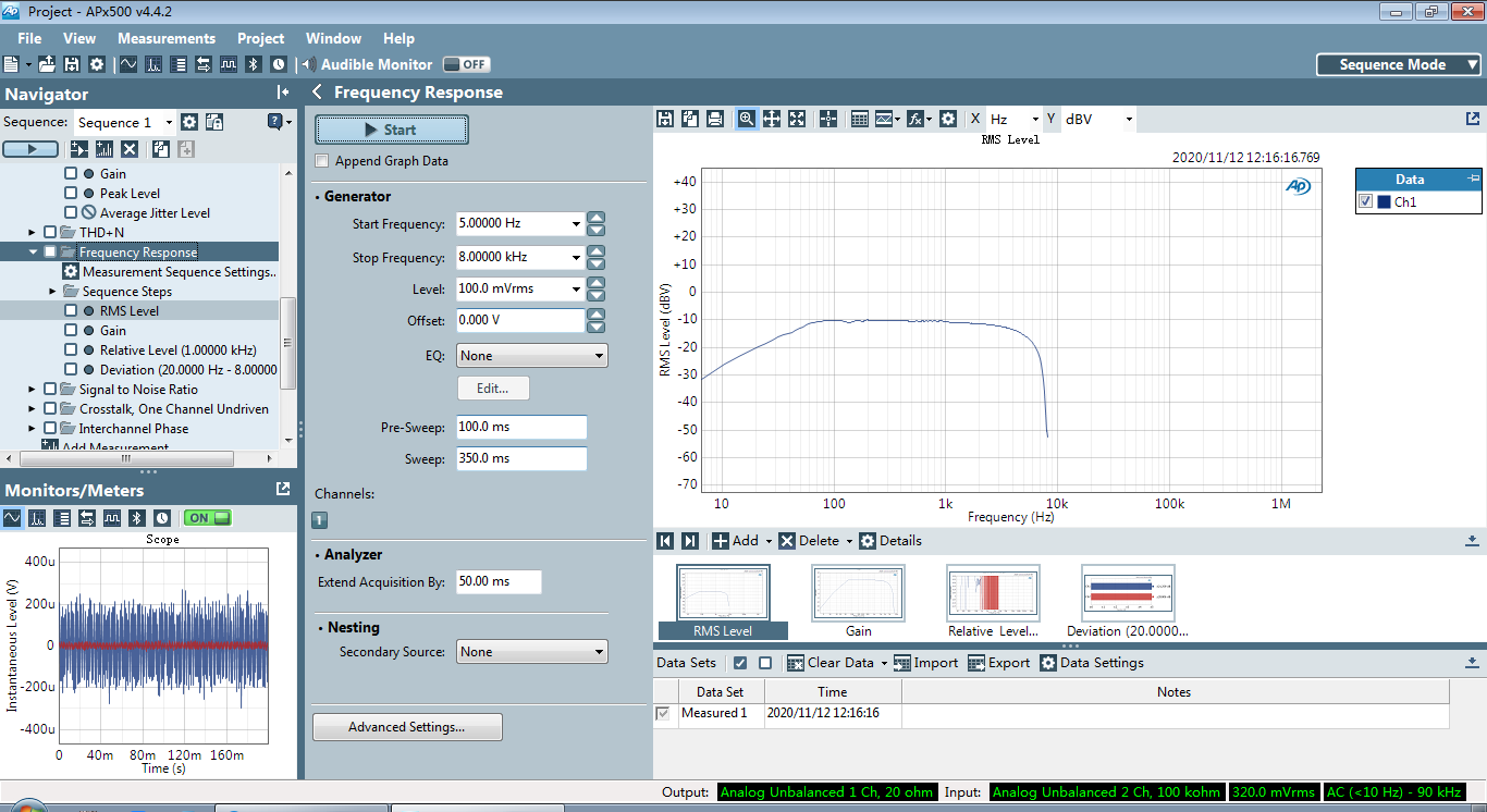

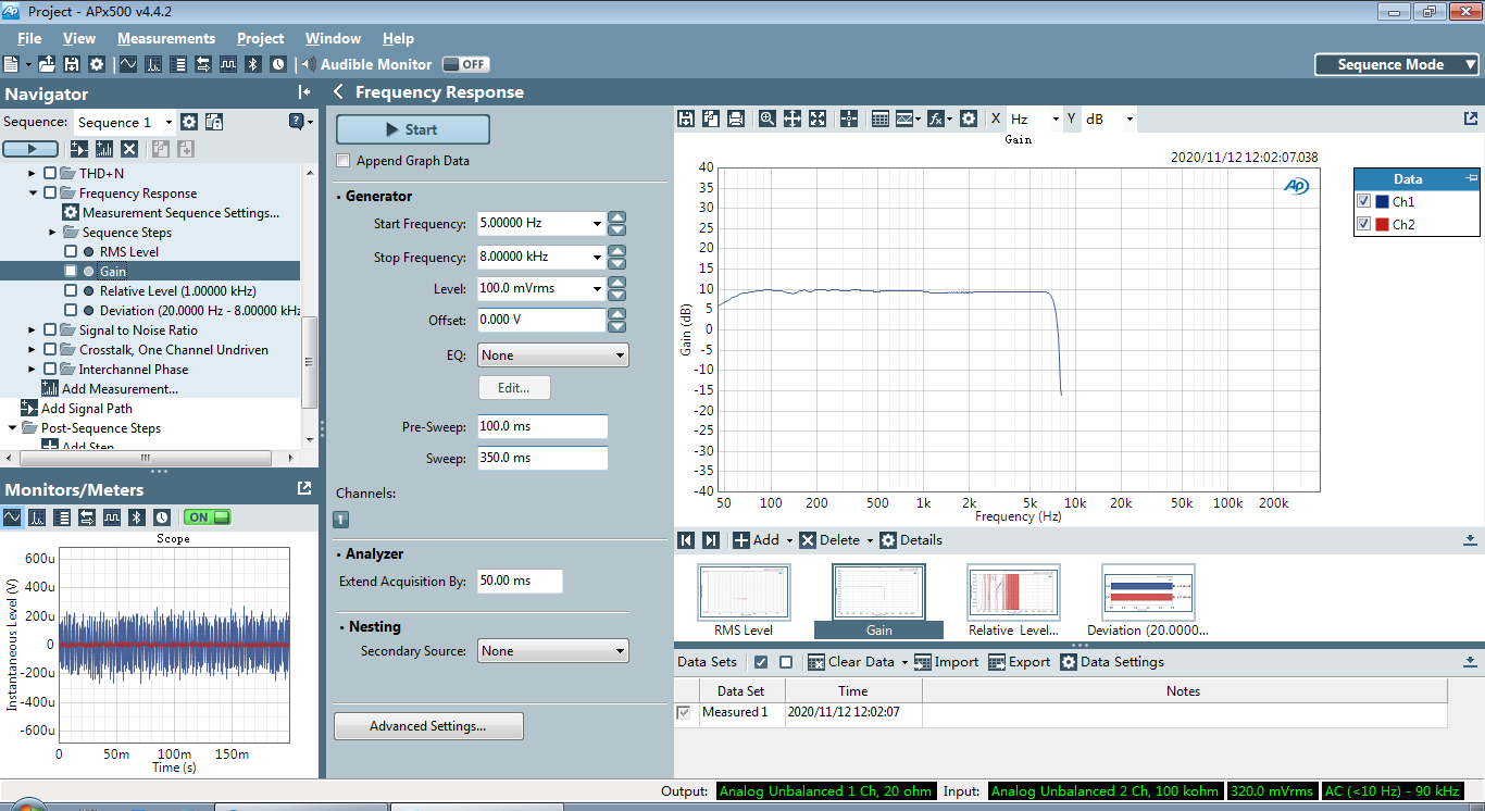

       We use project C:\ti\simplelink_audio_plugin_3_30_00_06\examples\rtos\CC1352P_2_LAUNCHXL\audio\audiohal_echo for testing. The project is analog audio input. The signal enters cc1352 after AD conversion, and the signal is sent directly from cc1352 to codec for DA conversion.We find that the frequency response of mono audio signal is worse than that of stereo audio signal. We only change one parameter, which is used to select mono and stereo audio signal.We have done experiments to verify that the codec chip has no problem.I would like to ask experts, whether other users have encountered the same problem, whether there is a solution. Figure 1 shows the frequency response of mono audio signal and Figure 2 shows the frequency response of stereo audio signal.

    I did the experiment again today. The results are as follows:
    1. Only modify the definition of NUM_CHAN as AUDIOHAL_CHANNELS_MONO in the code.Connect the left and right channels of the lineout with a cable, and the audio signal frequency response curve will decrease in advance.If the left and right channels of the lineout are not connected by wires, the frequency response curve of the audio signal is good.
    2. Modify the definition of NUM_CHAN as AUDIOHAL_CHANNELS_MONO and add "AudioHalParams.invertMono= false" to the original code.No matter whether the left and right channels of lineout are disconnected or connected, the frequency response curve is good;
    3. The input side will have no effect whether the left and right channels are connected together or not.
    4.This result is independent of bandwidth and gain. we use green input.Use the same input for STEREO and MONO.
