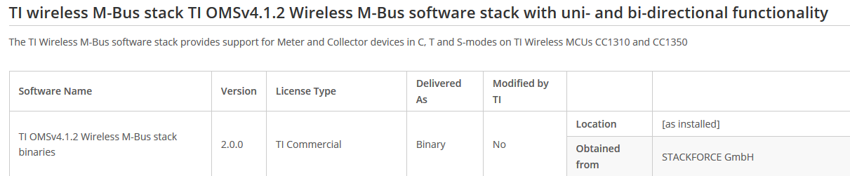

    I looked at the "TI wireless M-Bus stack_2.0.0_manifest" from wmbus :
    it specifies the below:
    Does it means that the stack .lib files in wmbus-cc13xx-rtos-2.0.0\lib) are provided for evaluation only and the production license need to be sorted with Stackforce?
    Or are the stack (ie lib files) provided for production and for free?
    I assume as well that paid technical support is available from Stackforce. Correct?
    Or is the source code of the CC1310 application example available for free from Stackforce on request?
    Thanks !
    A.
  • Hi AnBer,
    The stack as delivered on TI.com includes the TI Commercial license and should be OK for production as far as I'm aware. There is no royalties for CC1310 and CC1350.
    As for support, yes you should be able to get paid support from SF but hopefully we (apps) in TI could answer typical questions the user might have. As for the source code, this is not available for free.
