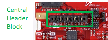

a) I think that maybe my connection problem may be related to the central header block. Do you think this statement makes sense? If yes, which jumper i must pull off?

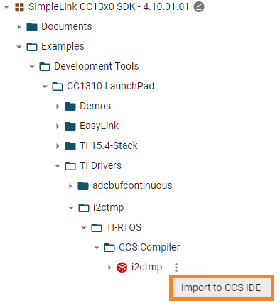

    1. I tought about using a TI-RTOS example as a starting point to my project so I added the "12ctmp" example though the Resource Explorer:
    2. I opened the "i2ctmp.c" file and erased all the code;
    3. I pasted 's code

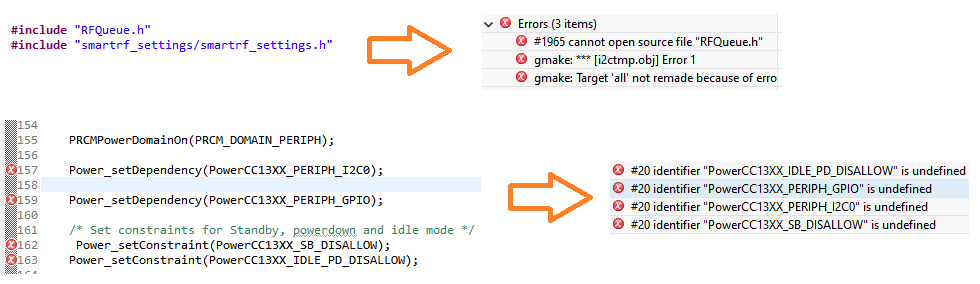

    4. I added this code (From 's answer in this Link)to enabe the power domain for peripheral (changing the PowerCC26XX_ ... to PowerCC13XX )
        PRCMPowerDomainOn(PRCM_DOMAIN_PERIPH);
        Power_setDependency(PowerCC26XX_PERIPH_I2C0);
        // Set Power dependecies & constraints
        Power_setDependency(PowerCC26XX_PERIPH_GPIO);
        /* Set constraints for Standby, powerdown and idle mode */
        Power_setConstraint(PowerCC26XX_SB_DISALLOW);
        Power_setConstraint(PowerCC26XX_IDLE_PD_DISALLOW);
        PRCMLoadSet();
        PRCMPeripheralRunEnable(PRCM_PERIPH_I2C0); // Enable I2C module
        PRCMPeripheralRunEnable(PRCM_PERIPH_GPIO);
        PRCMLoadSet();
    I got some errors like:

    "Basically, before you can use any peripheral, it needs to be powered on, otherwise you will most likely crash trying to write to inactive hardware. The peripherals which has drivers provided take care of this, but as I2C Slave do not have a driver, you need power it on yourself."
     I'm sure i'm mixing different sort of codes and i would like to know what is the right way to do this
