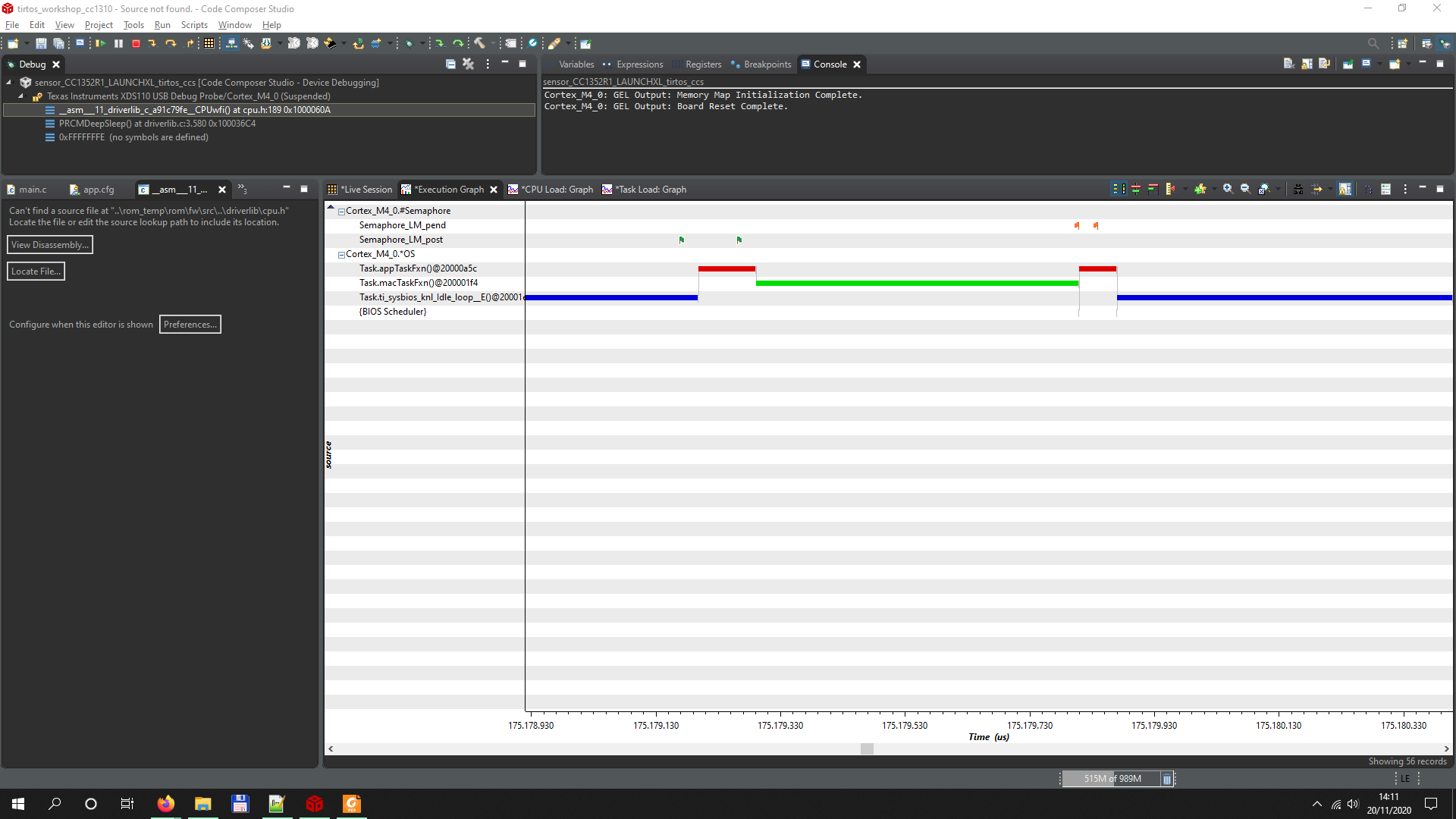

  • Hi MW
    My version is:
    Hi Marie
    1- 2-
    Watching the RTOS analyzer, I noticed that it spends most of its time idle, is this correct?
     Shouldn’t it go to sleep between network scans (5s)?

  • Hi Andrés,
    What you are seeing is the scan being scheduled (app task running), then the scan being conducted (mac task running). When scan has finished the results are sent to and processed in the app task.

  • Hey andres_dalmati,
    i didnt read the whole thread completely, but if you want the device to be low power inbetween scans in FH mode, set ApiMac_attribute_RxOnWhenIdle to false if you have finished scanning and listening for response. If I remember correctly, the sensor node RX is always on in FH mode until the node has connected to a network.
    best wishes
