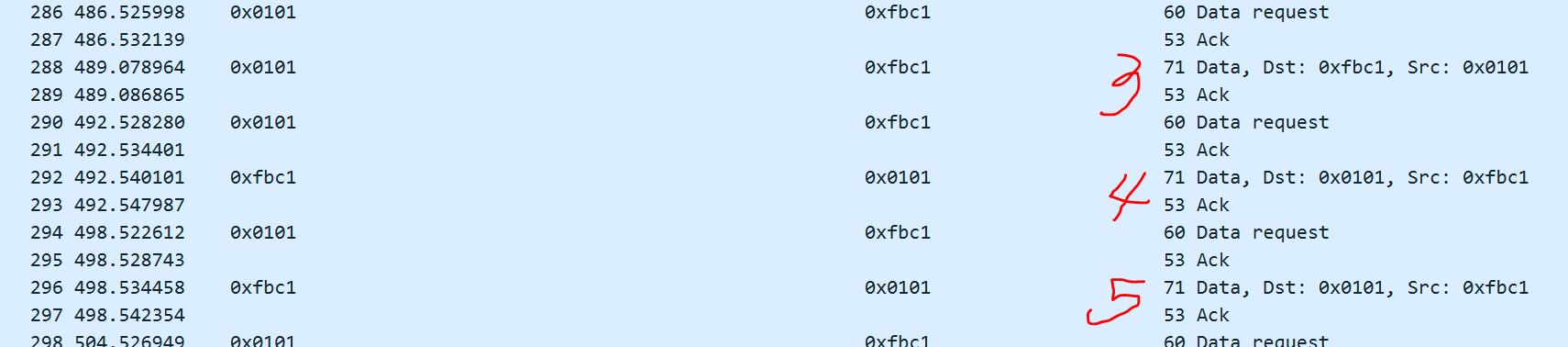

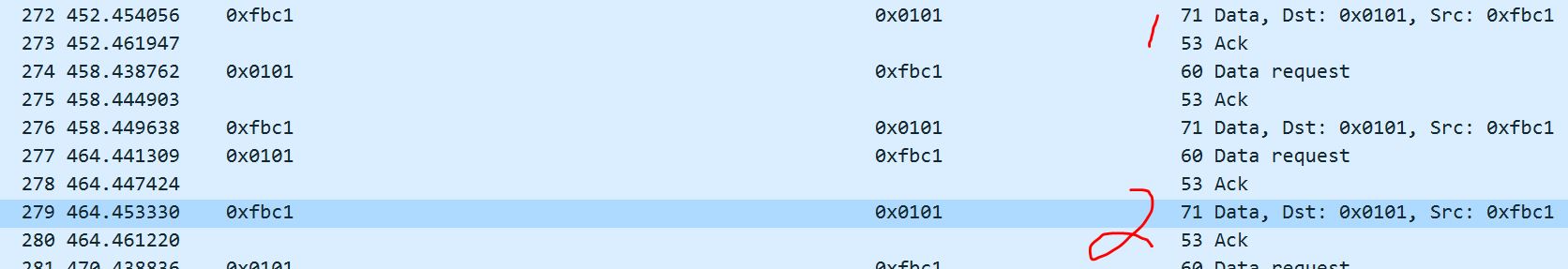

    now i can provide the packet in the air.
    in the picture below, the packet 1 is from sensor to collector, can be received and dataindcb is called.
    Packet 2 from collector to sensor, dataindcb in sensor also can be called.

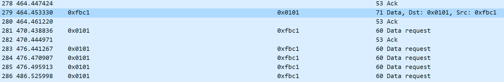

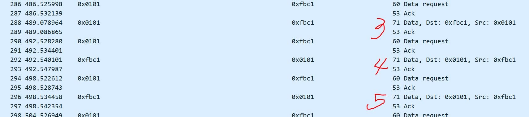

    Then I powered down the collector.
    The poll packet from sensor to collector is not acked.
    Then power the collector up.
    Packet 3 from sensor to collector is ok, dataindcb called by this packet.
    But the packet 4 and 5 from collector to sensor is failed. Sensor's dataindcb was not be called.
    Only in a few condition, the packet 4 and 5 can be received normally. Mostly the packet 4 and 5 from collector to sensor is lost.
    And I compared the security function between my code and examples, nothing is changed.
    So how I can find the reason why the packet can not be received?

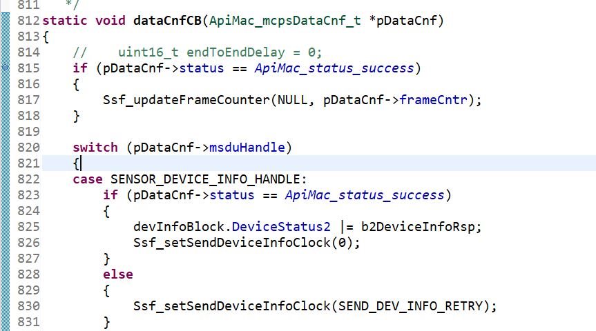

    And the breakpoint is in sensor.c file.
    As this picture shows, line 815.

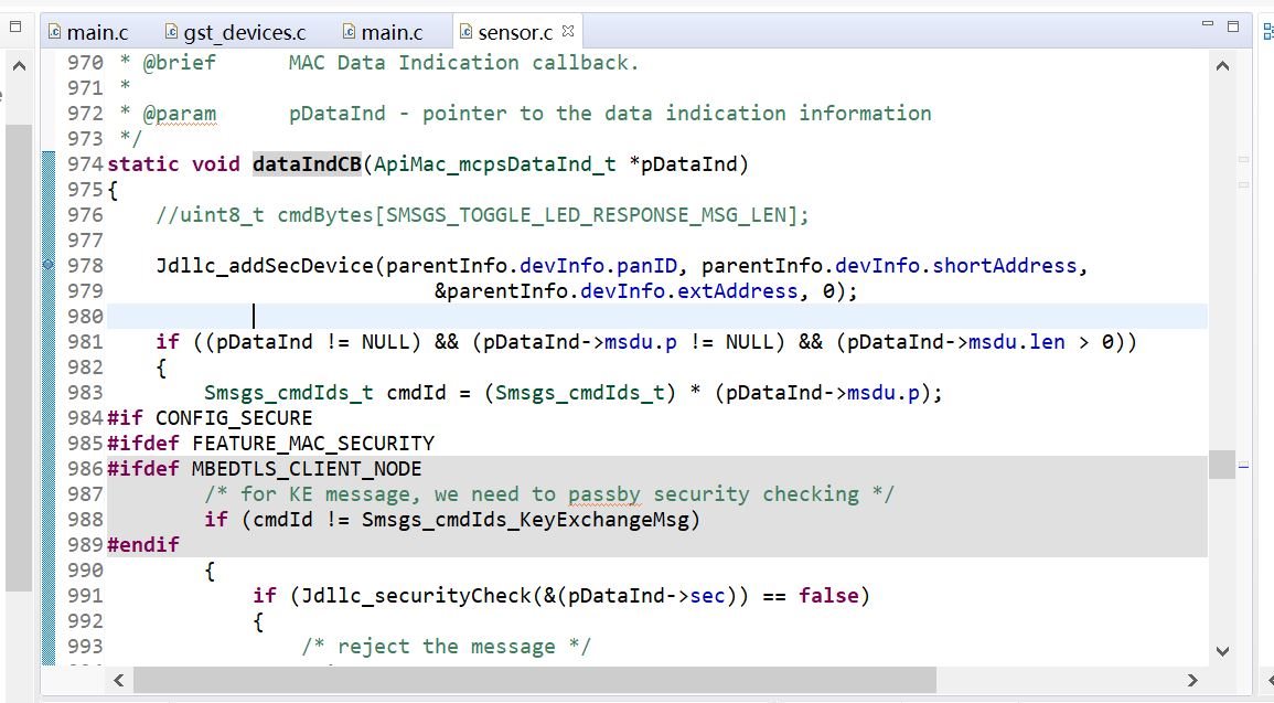

    Can you test with a breakpoint in dataIndCB() instead?
    (When the collector sends a packet to the sensor, the sensor.c task will receive a dataIndCB(). When the sensor acks the packet, the collector will receive a dataCnfCB().)
  • sorry for mistake your advice.
    I checked the breakpoint again, it is in sensor.c, line 978, the packet from collector is acked but this function is not be called.
