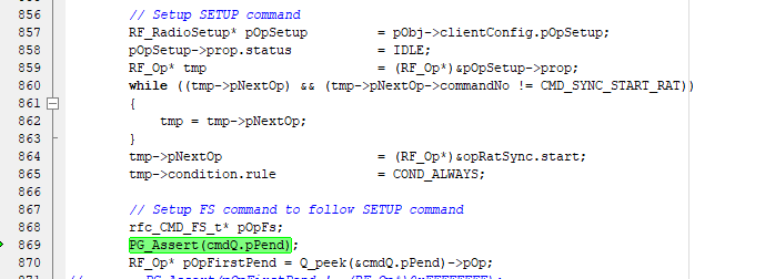

I'm using a custom board
I'm using tirtos_CC13xx_cc26xx_2_20_00_06
I'm trying to send packets via RF module to SPI serial flash in rate of ~ 100ms and after a few seconds I get the null pointer.
Looking deeper in call stack I fail in ti_sysbios_family_arm_m3_Hwi_dispatch__I.
Attach the screenshot

Yes I agree, It seems that a callback timer calls a DMA so this cause nested interrupts.
I'm more convinced it as an application bug and not a driver bug.

Well, actually it was a bug in my application. one of the tasks stack was insufficient. I increased the stack size of the task and the problem is resolved
