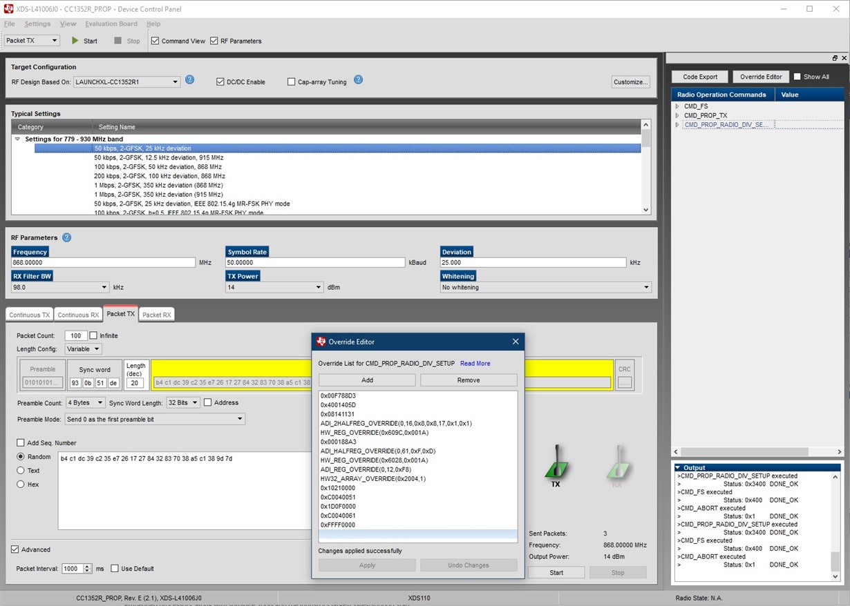

There is a need to xor crc result with 0xFFFF at the end. Here are my overrides configuration:
OVERRIDES:
HW32_ARRAY_OVERRIDE(0x2004,1),
0x10210000,          // The CRC-16 polynome: CRC-16-CCITT normal form, 0x1021 is x^16 + x^15 + x^5 + 1
0xC0040051,
0x1D0F0000,        // Init value  0x1D0F
0xC0040061,       /* Override crcXor  */
0xFFFF0000,       //   0x0FFFF
0xFFFFFFFF
I did a test RX/TX with SmartRF Studio between two boards and seems that override "0xC0040061"  is not working. There is no difference if I add that override to the transmitter device or not - CRC is the same on the receiver side.

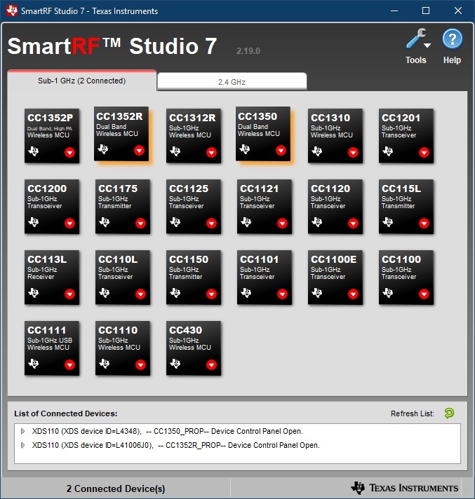

  • I did a test with two boards: (TX) CC1352R1 Launchpad and  (RX) CC1350 SensorTag using SmarRF Studio
    Configuration of RX side - CC1350:
    TX side (CC1352R):
    CRC on the RX (CC1350) is correct - no CRC Error.
    There is no difference if I add (0xC0040061 with 0xFFFF0000) or not, always packet is received with no CRC error. CC1352R - has ability to Xor returned CRC.

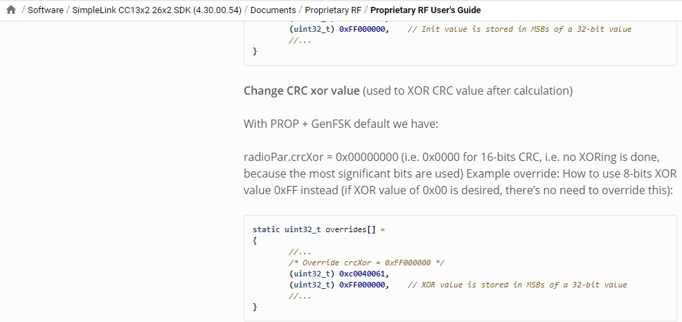

  • Thank you. It could look like the documentation for crcXor  is not correct. I'm able to replicate what you are seeing. But it could look like that the last override operate on the 16 LSB bits and not the 16 MSB bit as indicated in the documentation. I changed
    0xC0040061,
    // 0xFFFF
    0xFFFFxxxx,
    the 2 LSB bytes marked with x and that had an effect.
    Could you check on your end to see if you get the wanted effect if you change the LSB bytes?
  • Hi TER,
    now it is working as should, crc is correct. I changed the LSB bytes:
    0xC0040061,
    0x0000FFFF,
    Thank you.
