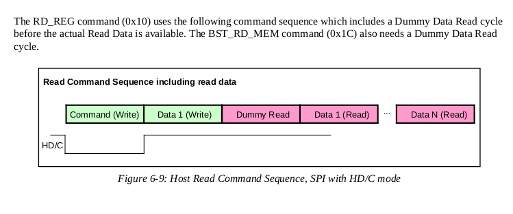

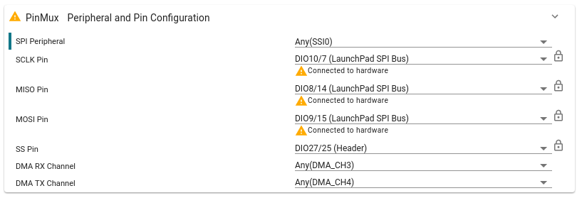

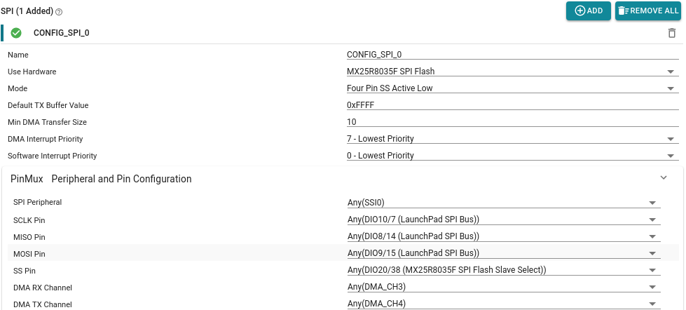

    I am using MX25R8035F SPI FLASH Hardware on the Launchpad connected to my S1D13541 EPD Controller.
    Wiring is as follows,
    • Since I am using the 4-wire SPI, I don't need to use another CS line to manually pull up/down, do I?
    • Do I still need to pull down SS (DIO20) in my code to do the SPI Transaction? Or is it handled by the SPI Driver whenever SPI_transfer(masterSpi, &spiTransaction) is called?
    I hooked up a scope as you suggested and observed the SS line (DIO20). But I do not see any GPIO state change in SS. I will append my latest code snippets and excerpt from the S1D13541 below.
    prod_code = s1d135xx_read_reg(S1D135XX_REG_REV_CODE);
    uint16_t s1d135xx_read_reg(uint16_t reg)
        //GPIO_write(SPI_CS,0);   // Pull Down CS. Removed while using 4 Wire SPI mode
        send_cmd(S1D135XX_CMD_READ_REG);
        send_param(reg);
        spi_dummy_read(NULL);
        spi_read(NULL);

    Am I doing the "Dummy Data Read Cycle" Correct? Even at the end of spi_read(NULL); I do not see masterRxBuffer getting populated.
    Any advice is highly appreciated.
    PS: GPIO State change of HDC Pin works fine.
  • If SS signal is not working, I suggest you to control SS using GPO driver by yourself instead of using SPI driver. I am not familiar with S1D13541 EPD Controller so I am not sure if your "Dummy Data Read Cycle" is Correct. I would suggest you to make SS signal correct first and then you can check if you can do SPI read and write successfully.
