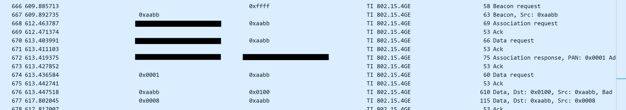

I am deploying 10 CC1350 sensors to 1 CC1350 collector, deployed in a non-beacon star topology utilizing the simplelink 4.x SDK, APIMAC_STD_US_915_PHY_1. Sensors utilize a push based model, with reporting interval of 1 minute. Polling occurs every 90 seconds. The devices are placed less than 15m from the collector
Problem:

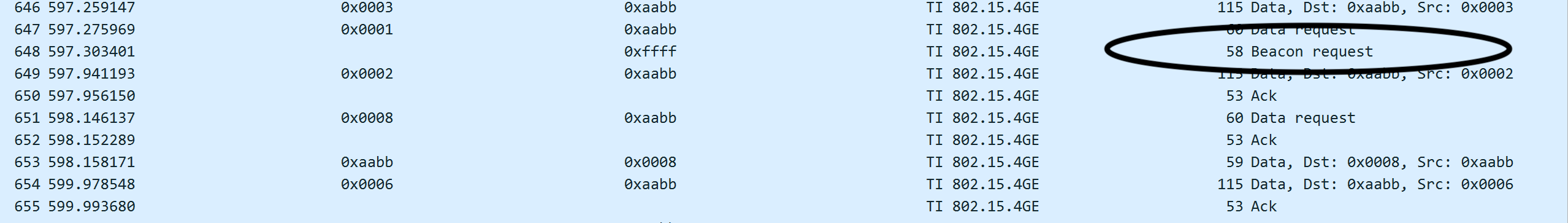

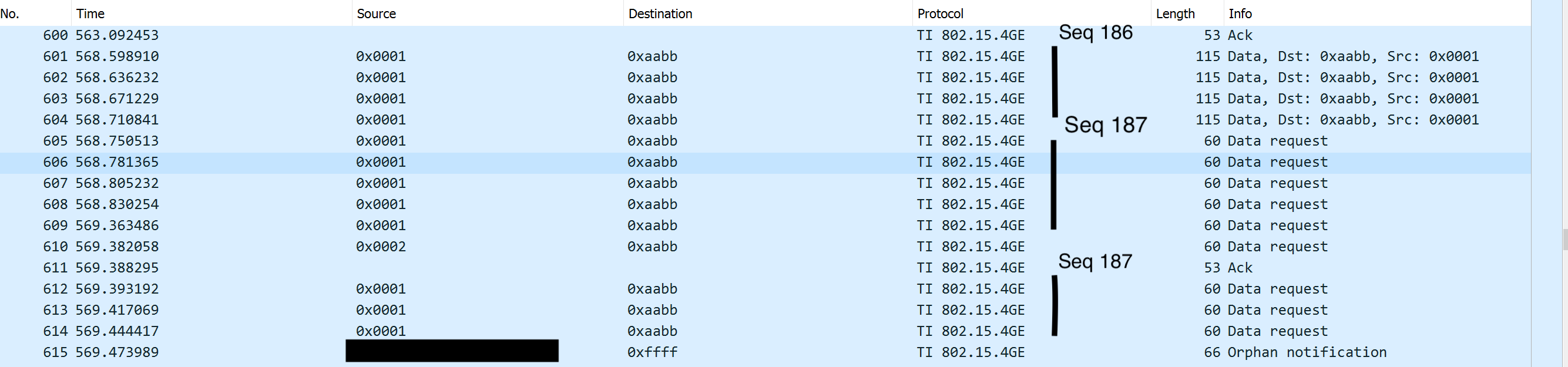

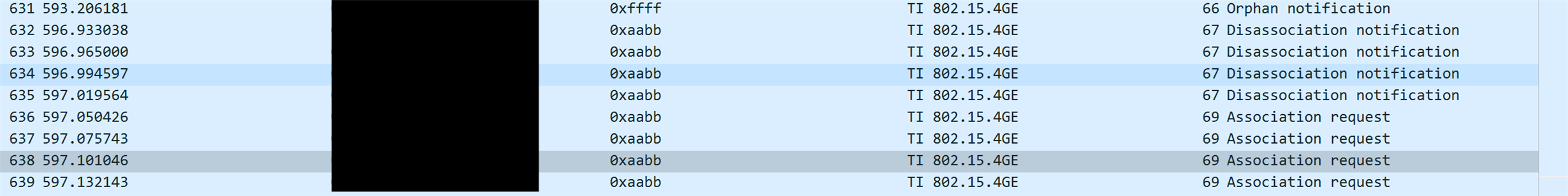

I am occasionally seeing one sensor disconnect from the network. It is not consistently the same sensor, and appears to rotate between a few. I have sniffed the traffic. It appears the disconnecting sensor does not receive an ACK, and rapidly tries to retry the request, leading to itself disconnecting. It's unclear why the sensor is not receiving an ACK. Once disconnected, I observe the sensor sending beacon requests. These requests are not always answered by the collector, causing further delay in reconnecting. The sensor typically reconnects after 10 or so minutes.
I have tried increasing the MAC TX and RX queue, but did not see improvement.
I'm looking for guidance on how to diagnose the root cause of this issue. Is this an interference issue?

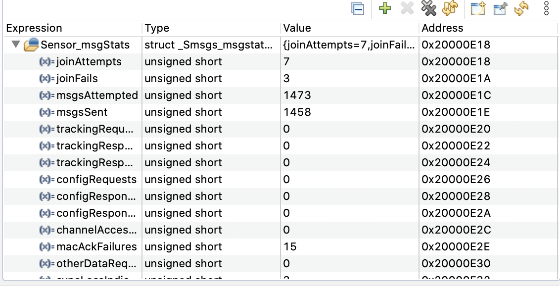

Update:
I've confirmed the disconnect is being caused by macAckFailures, leading to syncLoss. From the Sensor_msgStats, I can see a packet loss of roughly 1%.
