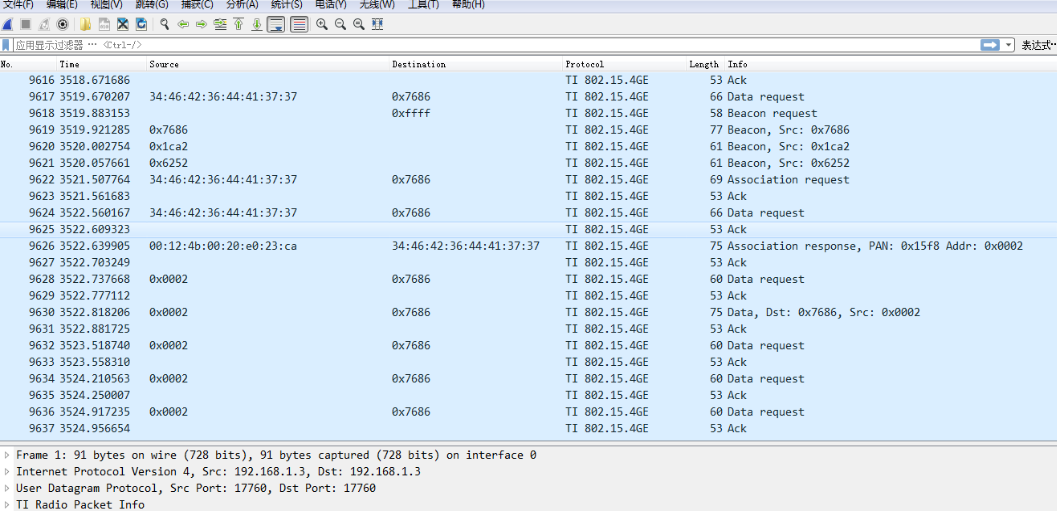

I have a problem with CC1310 collector and sensor.
collector failed to send message to sensor(sensor can't receive message from collector by sending date request).
I found it through printing by uart, the function    static bool sendMsg(Smsgs_cmdIds_t type, uint16_t dstShortAddr, bool rxOnIdle, uint16_t len,uint8_t *pData); return false, it happens occasionally.(I tried it 100 times and it came up once)
When sensor power-on again,back to normal.
Accessory is my sinffer file by pack snifffer and wireshark.(Start at line 9618)  The short address 0x0002 is sensor and 0x7686 is collector.

  • We use the 1.6 SDK, and the demo is collector and sensor. Our applications are all modified on this. This problem is not easy to reproduce. It will only be tested once a hundred times. Can you see any problem in sniffer's wireless packet capture?

      After a lot of testing, we found that this method did not solve the problem. Enlarge mac_ CFG_ TX_ DATA_ The value of Max will only delay the error prompt for a few packets. When I fail, I call apimac_ Mcpspurgereq() API is used to clear messages, but I found that it doesn't work. This API needs to pass msghandle data, and I should send that value. I found that every time I send a piece of data, this value will be + 1, and its range is from 0x80 to 0x9f. And we also found a phenomenon through the packet capture software. When the collector reports an error, the packet capture data can see the data sent by the collector, but there is no ack from the sensor
    The normal data interaction is that the sensor sends a packet of data to the collector and the collector returns a packet. However, in some cases, the sensor cannot normally receive the data replied by the collector. The phenomenon of bag grabbing is as follows:
    However, under abnormal circumstances, the collector will always reply to the sensor poll request, but the sensor does not reply with ack. The sensor can send data to the collector normally, and the packet capture phenomenon is as follows
    It looks like the sensor can't receive the data from the collector. The length of our payload data is 131 bytes. Does this have anything to do with the data traffic?

    The new issue you are seeing is likely due to the combination of the size of the payload, a short sensor polling interval and using the 5kbps PHY. This issue can be fixed by either changing PHY or increasing the sensor polling interval.
