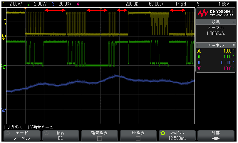

My customer is testing communication with OPT3001 using I2C of Main CPU in the CC1310, but is experiencing waiting time by I2C continuous access.
On the other hand, when I2C communication is performed on the Sensor Controller side, this waiting time is not generated.
Why does this wait time occur when I2C communication is performed on the Main CPU?
Also, is there a way to eliminate this waiting time?
The following sample code is used for the Main CPU side." Only "i2ctmp.c" has been modified.

The Sensor Controller side is created based on the "I2C Light Sensor"  sample software included in Sensor Controller Studio.
The following is a waveform image of the Main CPU side during I2C communication.
 The board used is LAUNCHXL-CC1310.
 Ch.1 (yellow): SCL (2V/div)
 Ch.2(Green): SDA(2V/div)
 Ch.3 (blue) : Current consumption waveform (2mA/div)
 The red arrows indicate the waiting time that is occurring.

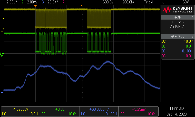

The following is the waveform of the Sensor Controller side during I2C communication.

    Looking at your scope, it seems to be related to the "write then read" transactions and in this case, the periods seems to be exclusive clock stretches (I would assume on both sides but for sure on the CC1310 side once it is the receiver). Why exactly is hard to say but typically I would say it relates to what else goes on in the system, the I2C receiver will force the SCL low while not being able to receive which on the ARM side means as long as you have yet to read out the last data received (and as there is no FIFO, this could be every byte).
    As for the Sensor Controller, this implements a bit-banged I2C Master which runs fully autonomous. This means that the "system delay" is no delay and it could be quicker to move between write/read as well as handle consecutive reads (as it does not wait to handle a particular interrupt but instead act in a polling manner).

  • Hi UNA,
    Clock stretch is the function of the receiver, it is not strictly limited to the role. For example, if you perform a burst read operation from the master, it would stretch the clock while waiting for you to drain the data register. Not that the slave should really care about this but it still does it, as it is how the receiver logic works.
    So in the ARM case, the stretch is likely (as I mentioned above) due to the master needing to drain the previous received data in SW. The sensor controller does not use the same peripheral (or any peripheral at all to be fair) and is also not impacted by other factors such as RTOS events and interrupts that could cause latency in the I2C processing.
