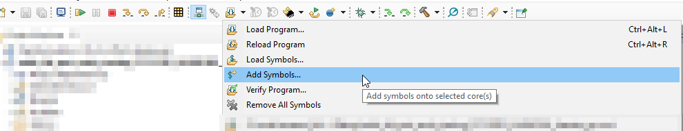

  • Hi Erwin,
    It is possible for sure using either linker directives or pragmas to conserve it, the project split is however the recommended approach.
    You could still debug a "full product" on the customer site, you just need to add the symbol files yourself. Say that you for example launch a debug session based on the "application project", then you would need to load/add the symbol/out file of the "bootloader" to the session in order to get the "full project" debugging experience.
    In CCS, this could for example be done as in the image below (once in a active debug session):
