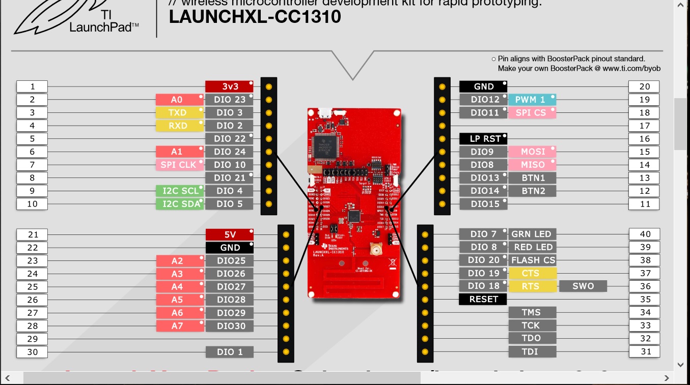

I am trying to run some I2C from CC1310 but with different slave then TMP006/TMP116.
I base my code on example: i2ctmp_CC1310_LAUNCHXL_tirtos_ccs.
I am not able to find where I2C pin definitions are because in CC1310_LAUNCHXL.c there are only some other pins.
Some functions in this project are completely external so that may be solution.
Where can I change I2C pins in such project?
Should I worry about anything specific when changing I2C slave device?
  • Every I2C device uses the same pins, that is the point. You can see the pins on the quickstart guide. Look at the green pins. Make sure to include the pull-ups!
  • The pins are defined in CC1310_LAUNCHXL.h

  • Search for I2C in the board files. In the .h file:
    /* I2C */
    #define CC1310_LAUNCHXL_I2C0_SCL0 IOID_4
    #define CC1310_LAUNCHXL_I2C0_SDA0 IOID_5
    In the .c file:
    const I2CCC26XX_HWAttrsV1 i2cCC26xxHWAttrs[CC1310_LAUNCHXL_I2CCOUNT] = {
    .baseAddr = I2C0_BASE,
    .powerMngrId = PowerCC26XX_PERIPH_I2C0,
    .intNum = INT_I2C_IRQ,
    .intPriority = ~0,
    .swiPriority = 0,
    .sdaPin = CC1310_LAUNCHXL_I2C0_SDA0,
    .sclPin = CC1310_LAUNCHXL_I2C0_SCL0,
