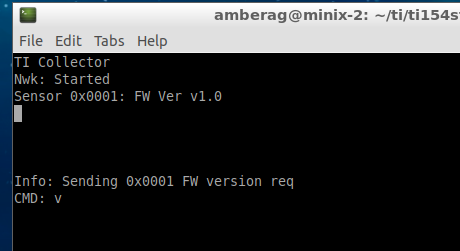

    After which I started the Linux GW using SDK version 3.30 as shown below and connected the sensor node
    Then sending the cmd v to check the firmware version on the sensor node to verify devices have successfully joined the network.

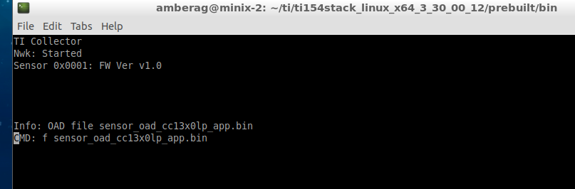

    Then the firmware to be updated  sensor_oad_cc13x0lp_app.bin was selected provided by TIs SDK in simplelink_cc13x0_sdk_2_30_00_20/examples/rtos/CC1310_LAUNCHXL/ti154stack/hexfiles/oad/sensor_oad_cc13x0lp_app.bin

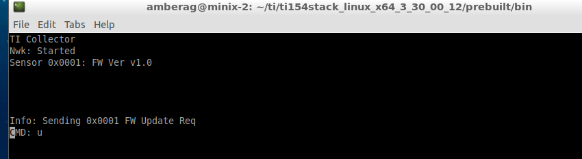

    Afterward the CMD u was invoked to start the OTA transfer process to the sensor via 15.4 stack. However, after starting the above process, the sensor device outputted the following error message that the OAD has even failed to start else I would have seen something similar to this:
    OAD Block: 1
    of 928
    OAD Block: 2
    of 928
    What is strange to me is that I am using all the images/binaries provided by TI and following the steps in their tutorial and still the OTA example did not work.
    Please can you or someone at the TI help me to solve this issue. I really need a direction or solid solution here.

  • Hi Rajeev,
    Apologies for the delay.
    Have you made any progress on your issue?
    Since you are using the CC1310 device on the sensor side, you need to use version 3.30 for the Linux SDK, and you have to enable the TIRTOS_IN_ROM in the Makefile.
    Elin
  • Hello Elin,
    I managed to get the OAD setup up and running but using Easylink examples  from the SDK and not the TI15.4.
    Now I have a complete understanding of how the OAD mechanisms work and currently, we are porting this for our custom-designed CC1310 board.
    Thank you!
    Rajeev
