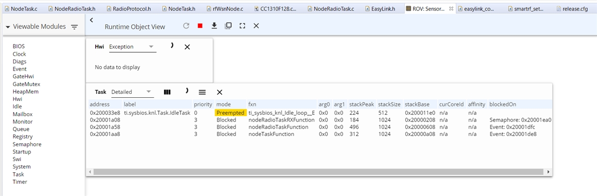

Hi everybody!
In my application I start with the example rfWasConcentrator and rfWsnNode with Easylink.

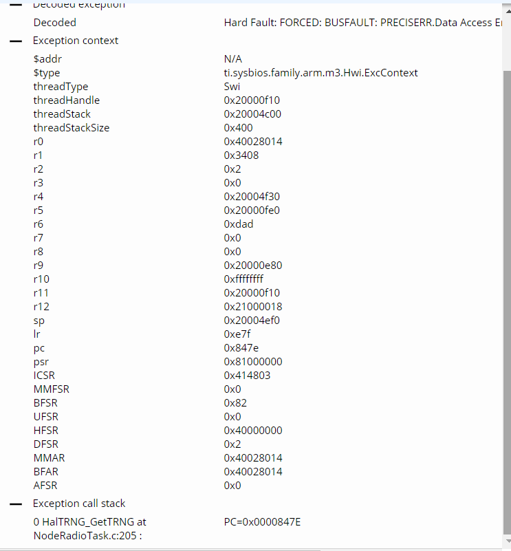

I modify the example to use EasyLink_transmitCcaAsync in my application. But after few successful transmition the code stuck in
ti_sysbios_family_arm_m3_Hwi_excHandler__I)
I am using the SimpleLink SDK 4.10.1.01 . My code is below.
