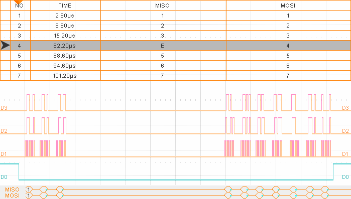

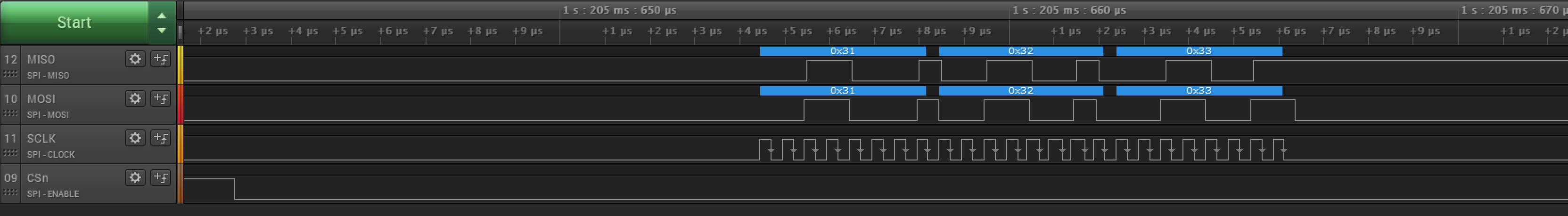

Everything works mostly as intended, with the exception that the 4th bytes I receive on the master side is always corrupted, while there is never a problem with the data received on the slave side.

    The application on the master side looks like this:
    spiCSactivate(handle);
    spiWrite(handle, testTxBuffer, testRxBuffer, 3);
    uSecDelay(1000);
    spiWrite(handle, testTxBuffer + 3, testRxBuffer + 3, 7);
    mSecDelay(1000);
    With all the above, the behaviour is the same as in my original post.

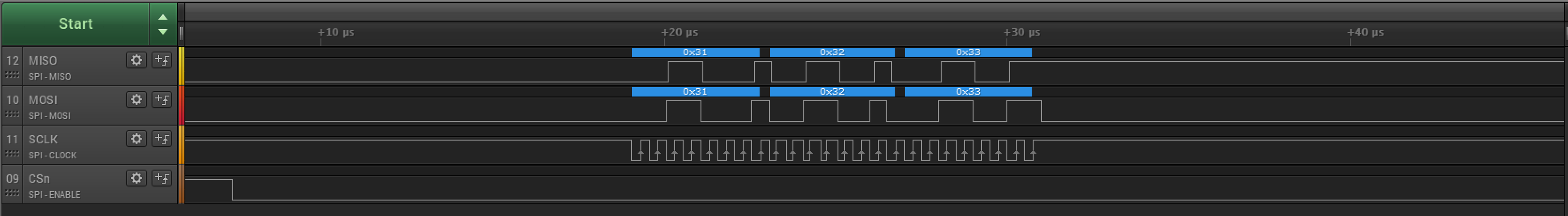

    I've ruled out problem on the master side, because when I make the following change to the slave, everything works flawlessly:

  • Hello Siri,
    Here are plots of the first byte and the full transaction when the slave is connected:
    And here are the same plots when the slave is disconnected:
    The signals in the plots are as follows:
    D0: CS
    D1: CLK
    D2: MISO
    D3: MOSI
    The data being transmitted is the same on both ends and is "12346789A".
    Borislav
  • Hi Borislav
    I tried the .hex file and the .out file from your zip file, but was not able to see any communication on the MISO line.
    Instead I copied the uart.c file into my project and was running it.
    I was not able to see any problems:
    In the above plots, when everything works, I am running your slave code.
    This code is settings spiParams.frameFormat = SPI_POL1_PHA1;
    However, when you compare my plots and your plots, you will see that in my plots SCLK is 1 when IDLE, but in your plots, it is 0.
    Since the difference between these tests are the master code, I changed my master code to use
    spiParams.frameFormat = SPI_POL0_PHA1; The slave code is kept the same:
    In this case, my SCLK line behave the same way as in your plots, but I get an error in the 4th byte (like you do). This is because the slave code is using the wrong configuration compared to what the master is doing.
    I now modified your slave code to use spiParams.frameFormat = SPI_POL0_PHA1;
    BR
    Siri
  • Hi Siri,
    Thanks for your help. The error was indeed in the master as it was only able to "work" when the slave was configured to POL1, PHA1.
    Borislav
