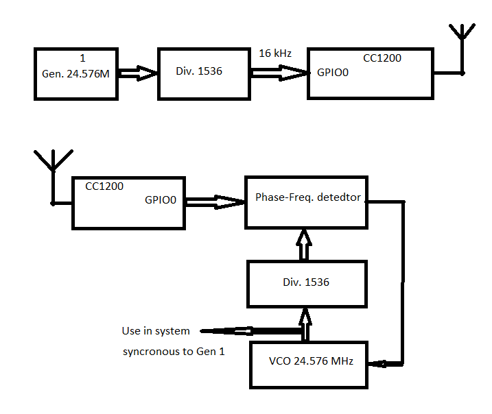

I use CC1200 in transparent mode, OOK modulation. I set GPIO2 to output clock, GPIO0 to input data. I send 16 kHz clock to data input. I try to set different data rates, but only data rates low 125 kHz sets correct frequency on GPIO, all values higher set 125 kHz clock. I see signal on the receiver and RF signal in transmit antenna, in both places I see big jitter. I see my data is clocked by 125 kHz clock (or lower? if I set it lower). But in User Guide I read: in transparent mode and OOK modulation data go directly to power amlyfier. For calculating register values I use Smart RF Studio. Testing - on TI evaluation board.
How I can remove clocking data by 125 kHz and direct transmit it to PA?

    Data on the air have big jitter. I see by oscilloscope on transmit antenna.
    I change bitrate on TX side (registers SYMBOL_RATE0-2). Then I set value below 125 ksps, it set correct, I see on GPIO2 (TX side) correct frequency, but if I set value higher 125 kbps, I see 125 kHz.
    My problem is only on TX side. Data on RX side are the same as on TX antenna.
  • If you want to send 16 kbps, why do you adjust the SYMBOL_RATE to > 100 kbps?
  • I need to use radio for PLL, and I need low jitter and correct signal front positions.
  • Would you be able to share a blokc diagram or similar how you plan to use the C1120? I don't understand what you mean by "use radio for PLL", please elaborate.
  • This is a block diagram of my system.
  • Transparent mode on CC1200 will generate jitter and we generally advice to oversample the received signal to ensure good enough RX performance. Due to the jitter, the receiver should not use edge detect.
