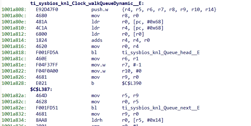

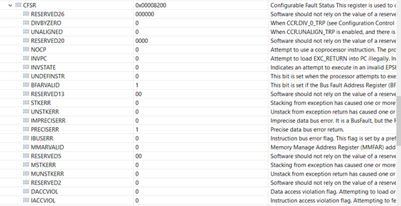

I am developing with CC1310F128, SimpleLink 4.10.1.01 SDK.
I have debug a Hwi exception following the documentation, but I have a doubt what is possible causing this exception (I could not find this functions)
Bellow the ROV screen when the exception occurs
CFSR Register
