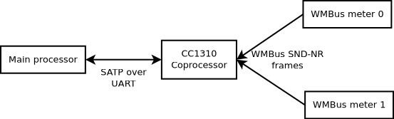

  • Hi Harmjan,
    Thank you for proviing so much detail. However I don't understand the set-up. Culd you make a figure and name all the different devices in play?
  • Hey Marie,
    The systems looks as follows:
    The main processor is where I want to do the decryption. The Coprocessor is where the StackForce WMBus stack runs, the main processor configures the coprocessor over UART using the SATP protocol. The WMBus meters periodically send out SND-NR frames that are received by the coprocessor and forwarded to the main processor.
    I have also attached the logic analyzer and have received the following Serial MAC V2 frame (part of the SATP stack), what you can see in this frame is that the received telegram after the DLL header is only 59 bytes while it should be 64:

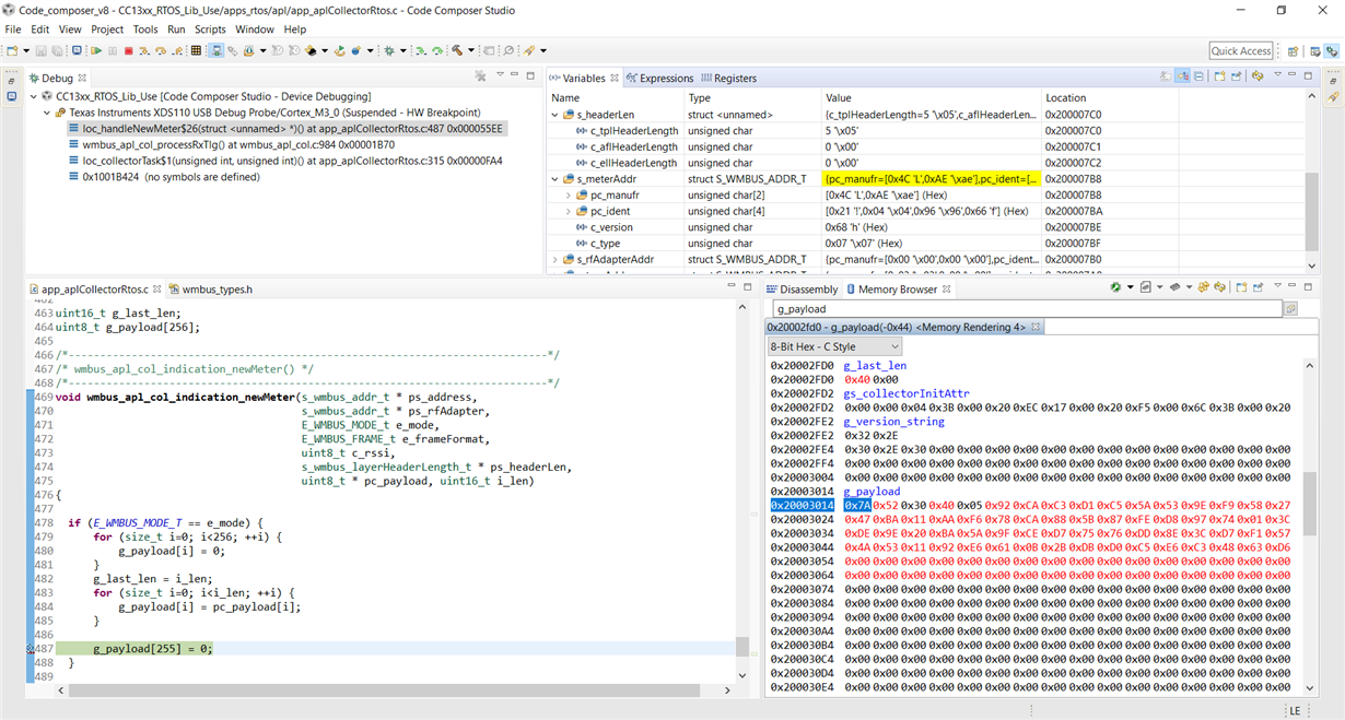

  • Hey all,
    I have tried to use the lib version of the stack and still have the same problem. I made minor changes to the file app_aplCollectorRtos.c to set the stack in enhanced installation mode and set a breakpoint in the indication handler to inspect memory. Below is a screenshot:
    The same problem happens. You can see in the Variables window that `s_meterAddr` is set to the same address as the SATP example I dissected above. The TPL Header length is still 5 and the length of the payload (set in `g_last_len`, visible in the Memory Browser window) is 0x40 = 64. The TPL header is the same except for the access number (0x7A, 0x52, 0x30, 0x40, 0x05). Then there are 59 bytes of payload left which you can't decrypt since it's not an multiple of 16.  Just copying the next 5 bytes in memory also didn't help me decrypt them. I also think I should be able to decrypt the first blocks if there were only some bytes missing at the end so there are bytes missing at the start, it's different data or my decryption attempts are wrong.
    I attached the version of app_aplCollectorRtos.c which normally resides in wmbus_cc13x0_rtos_2_0_0/wmbus-cc13xx-rtos-2.0.0/apps_rtos/apl/app_aplCollectorRtos.c. I set the active configuration to the APL T2 collector. In these changes during initialization it checks that the stack version is 2.0.0, sets the stack in Enhanced installation mode, erase NVM memory and synchronizes. An if was hardcoded to true to prevent the stack from going to sleep. In the new meter indication is the length and payload copied to global variables to make them easier to read in an debugger (I'm not that proficient with code composer). I also included UART driver headers at the start of the file which are a remnant of another experiment. I'm pretty sure I didn't edit any other files but haven't used git well for this experiment.

    uint16_t g_last_len;
    uint8_t g_payload[256];
    /* wmbus_apl_col_indication_newMeter() */
    void wmbus_apl_col_indication_newMeter(s_wmbus_addr_t * ps_address,
                                           s_wmbus_addr_t * ps_rfAdapter,
                                           E_WMBUS_MODE_t e_mode,
                                           E_WMBUS_FRAME_t e_frameFormat,
                                           uint8_t c_rssi,
                                           s_wmbus_layerHeaderLength_t * ps_headerLen,
                                           uint8_t * pc_payload, uint16_t i_len)
      if (E_WMBUS_MODE_T == e_mode) {
          for (size_t i=0; i<256; ++i) {
              g_payload[i] = 0;
          g_last_len = i_len;
          for (size_t i=0; i<i_len; ++i) {
              g_payload[i] = pc_payload[i];
          g_payload[255] = 0;
    }/* wmbus_apl_col_indication_newMeter() */

    I hope this helps TI reproduce the problem locally. The sample I've mentioned before below (if I put a link in here now it seems to truncate the rest of the post) shows that the AES blocks should start after the TPL header.
