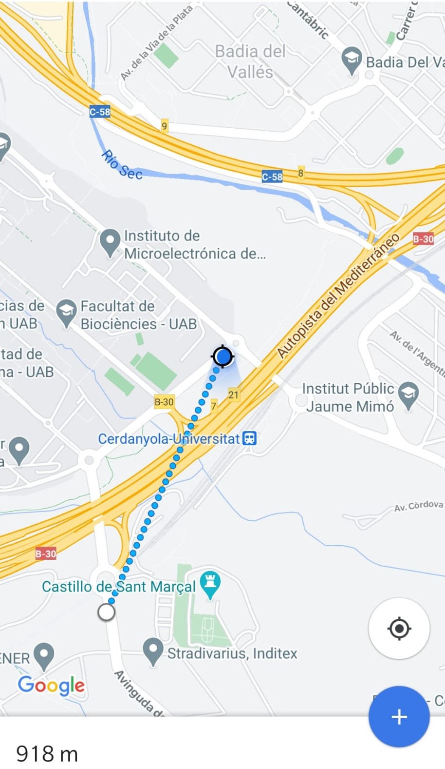

  • Could you post a screenshot of a map showing where you placed the node and collector for your range test?
  • Hi TER,
    Here you have it. The blue dot is the position of the collector, the white dot is the position of the sensor.
  • How did you mount the LPSTK for this test and how far above the ground did you have it?
    Also, did you have line of sight or did you have cars in between? From the map it looks like you used a parking lot as test space.
  • Hi TER,
    We connected the LPSTK boards to two laptops, around 1m above the ground. Then, one of us started walking while carrying the sensor from the blue dot to the white dot, the other stayed at the blue dot. Yes, it was a parking lot.
    Today we tested it again at a different location, more similar to the line of sight scenario. The boards are 1m above the ground. Here you have the screenshot of the map. We have still not reached the minimum excepted range of 1497m, maybe due to the conditions of the test site, but we are closer than before.
    One question, we plan to use the sensors at certain height (around 10m above the ground) and we saw that your range estimator provides a range of 6km. Do you think that if we place the sensors at this height at the same test site of the map this would be reachable?
    Thank you,
    Mario
  • Looking at the map I would look into placing one board at one of the small hilltops in the wood area to the south with line of sight to where you have tested now. I would assume that the cars on your previous sight limited the range.
