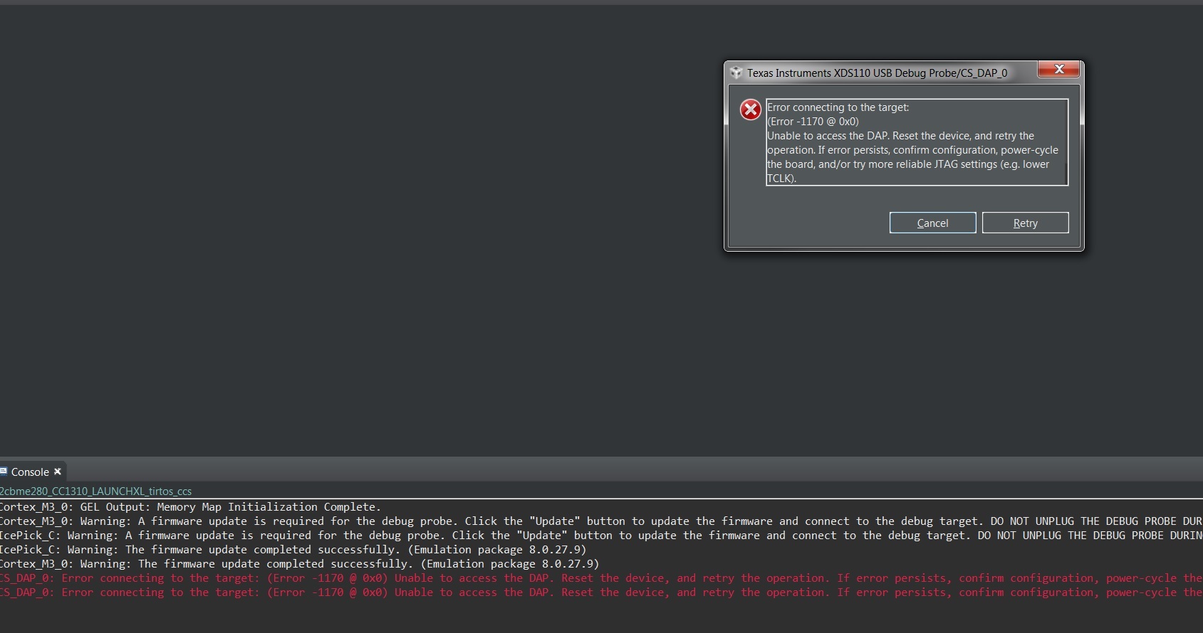

  • I have download and installed CCS 8.1.0.
    Project example build fine.
    Problem started when I was trying to launch debug.
    Firstly CCS forced me to do some update on LaunchXL:
    Then it could not connect to board:
    Artur
  • Not sure what that message means. Have you tried to see if you get contact with the board using SmartRF Studio for example?
  • Now it have just started to work, for now I am able to see that BME did not send any data.

  • It is indeed starting to work.
    I had switched SDA and SCL and I am able to see data.
    If everything works for some time I probably end this topic soon.
