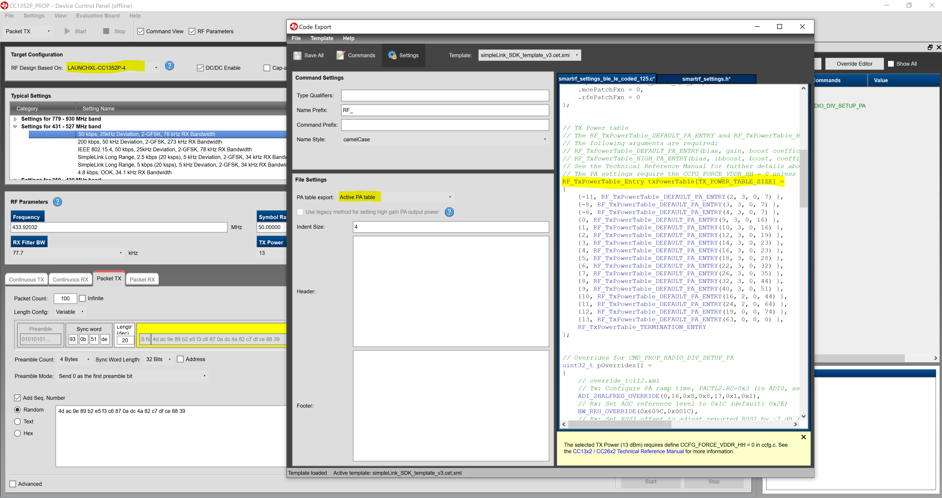

In SmartRF Studio (including lastest 2.20.0 version), I am unable to generate PA Tables for any band in the range of 359MHz to 527MHz.
However, the lower band 169MHz and higher bands 779MHz to 930Mhz, all allow PA Tables.
Is this a known problem, limitation or by design?
