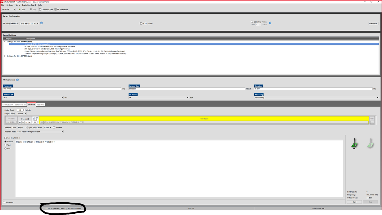

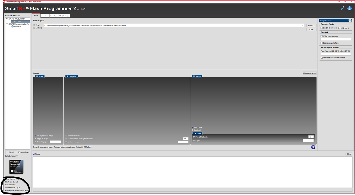

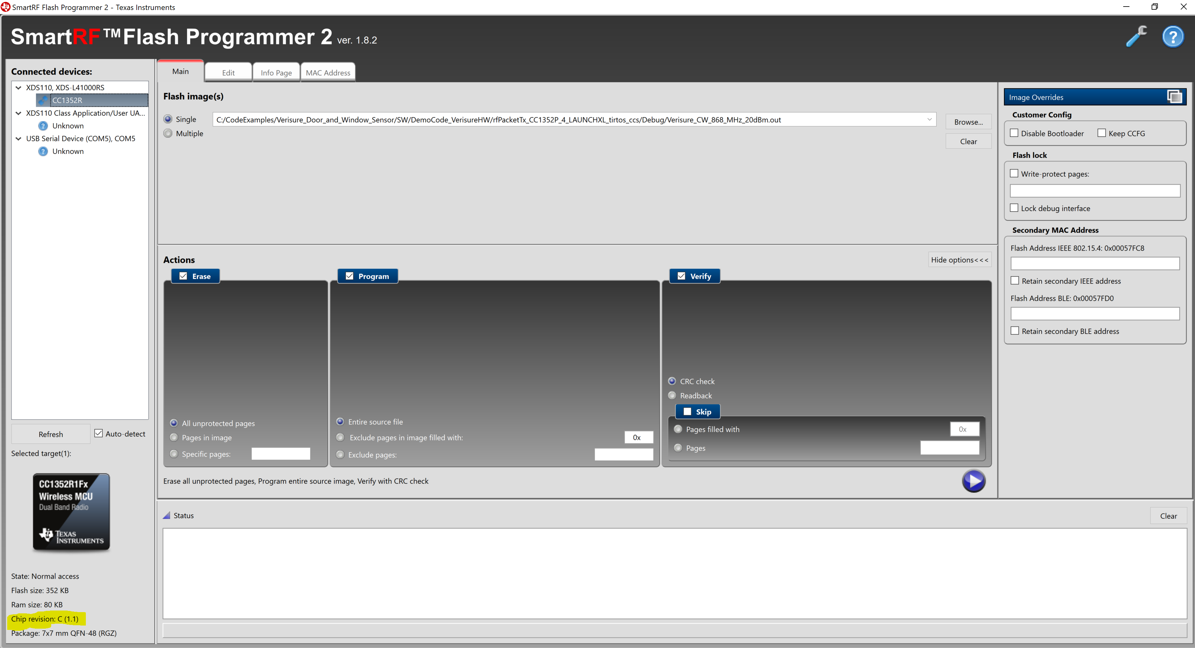

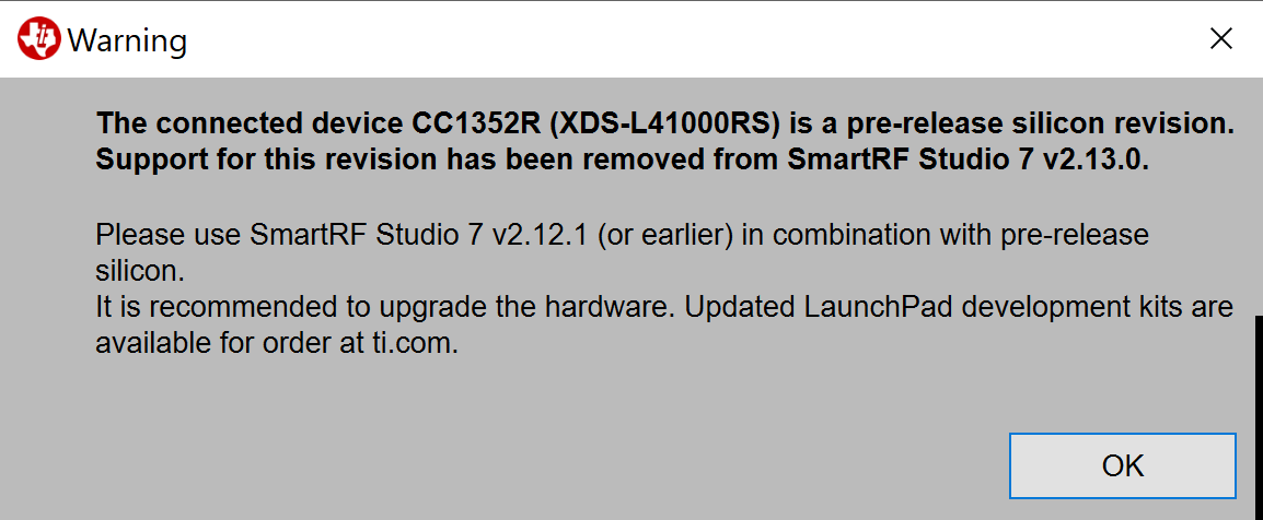

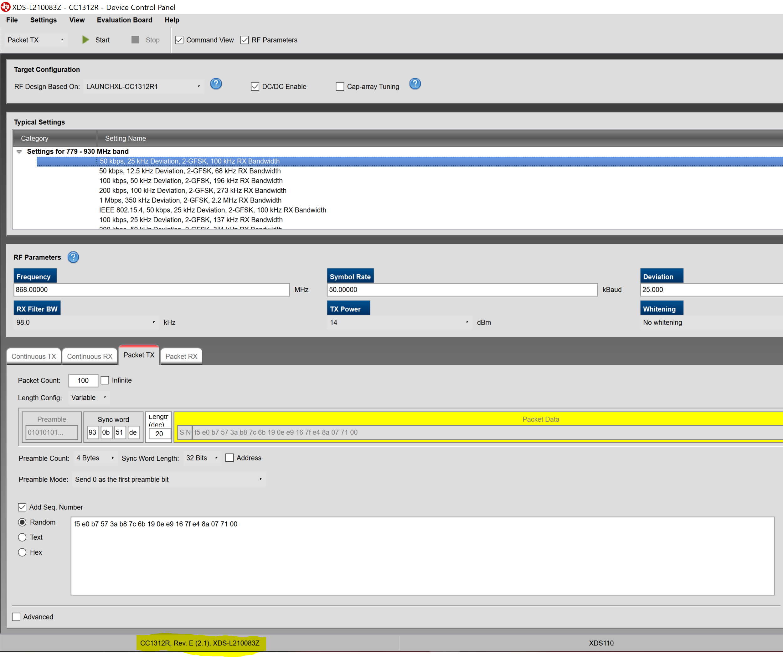

  • I do not have the info regarding lot number etc. available.
    Please download the newest version of SmartRF Studio and connect your boards. Studio will display the version of the board (it reads the version register):
    I do not think rev. C is supported (so if you have rev. C or older) Studio will tell you that you have an un-supported version of the board:
    If I use the SmartRF FlashProgrammer 2, I will see that the device that was not supported by SmartRF Studio was a rev. C device:
    Siri
  • Hi Siri,
    Ok, here we go with the results obtained from your suggested test:
    It appears the MCU is revision C, and the LAUNCHXL is revision A.
