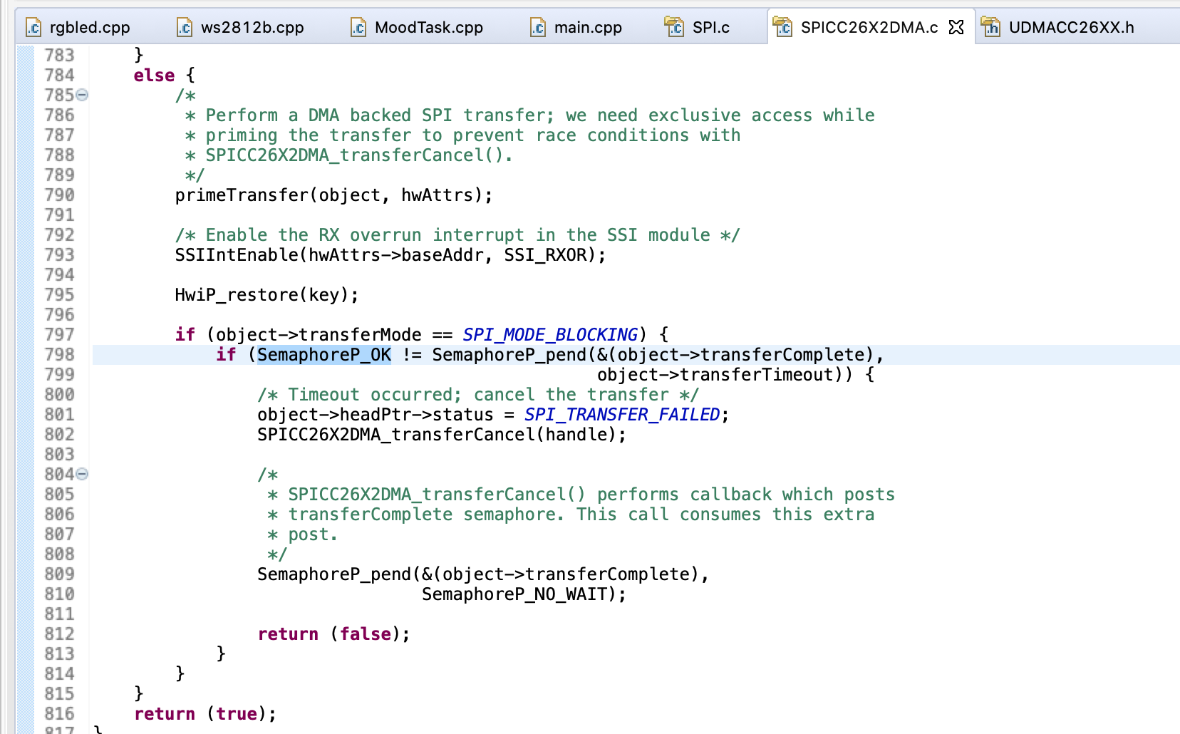

using SimpleLink SDK 4.20, my code is based on the TI 15.4 sensor project.
I spin a new TIRTOS tasks which, among other things, initiates SPI transfers on a regular basis. Everything seems to be working well, except if I enable DMA for the SPI transfers (DMA is needed for more predictable timing).
With DMA enabled, the app asserts here at line 798 (the semaphore_pend function actually returns SemaphoreP_OK), but stepping over that line doesn't work, and if I pause the debugger, I am in the main app exception handler from main.
Any pointers in troubleshooting this are appreciated!

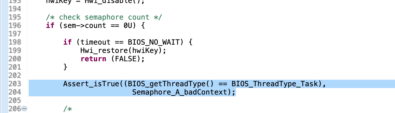

  • After enabling more debugging in my cfg, I see that the assert is at line 203 of Semaphore.c in sysbios/knl:
    What should I be doing differently to make this work?

  • Hi Siri,
    well, in both instances, I'm doing a SPI_transfer(). One just doesn't work if DMA is used, the other works OK. It's a small class used in the context of a tirtos task. Relevant bits, maybe something will seem obviously wrong to you. I am working on creating as simple a use case as I can to reproduce the issue.

    void RGBLED::output() {
        SPI_Handle spi = SPI_open(spiIndex, &spiParams);
        SPI_transfer(spi, &transaction);
        SPI_close(spi);

  • Hi Siri, yes, I was using minDmaTransferSize to enable/disable DMA transfers. The count is around 620 bytes. And yes, the problem occurs when count > minDmaTransferSize.
    I have reworked some logic in the app. In the end, I _think_ the transfers occured outside the context of the task (due to using C++ and C wrapper functions for callbacks), causing problems.
    While I am not entirely sure that is the case, I guess this can be considered resolved.
