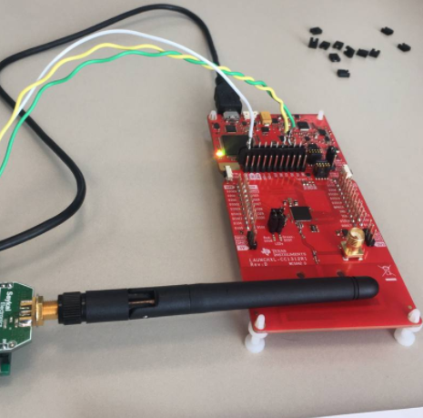

I am doing some tests to achieve optimum range. to do that. I am comparing my results with eval board. I have two custom board and one eval. One of my custom board is transmitter. Second one ise receiver.
I put my transmitter custom board 1.5m far from receiver custom  board and eval board.

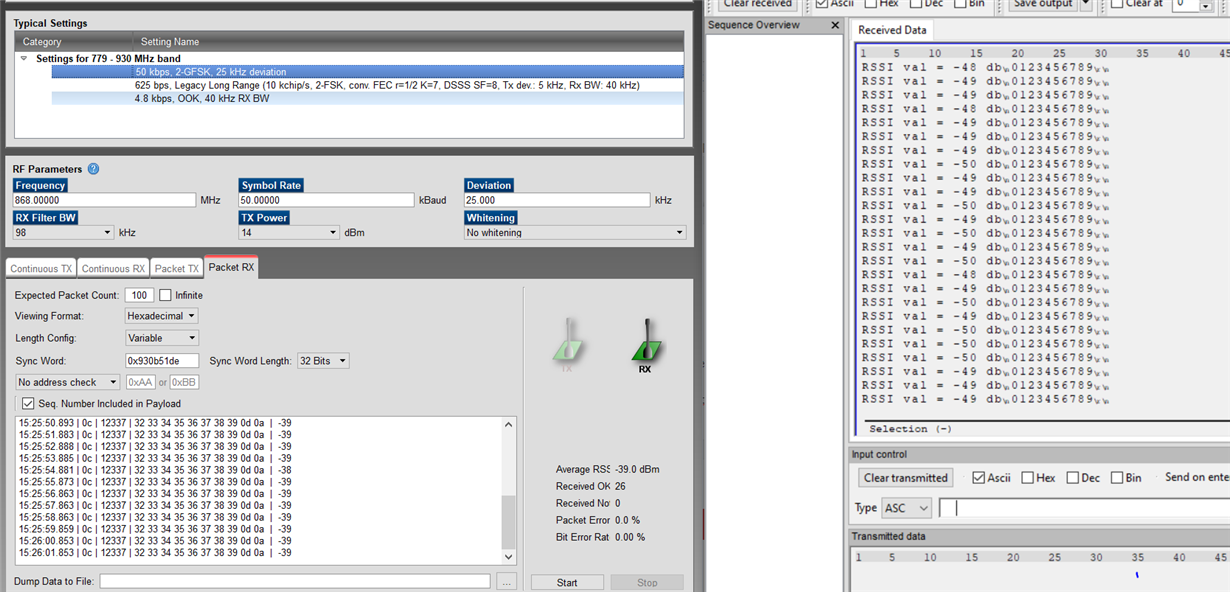

as you can see in up picture, there is a one receiver board and one eval to see rssi value on device control panel. to see rssi value on control panel. I delete all code from board using flash programmer. thus I was able to see rssi value on both board. the distance and transmitted data is same for both board.
So the rssi value that I see on control panel is around -(38/39) dbm for both board. Thats mean when there is no code inside board everything is okay I think.

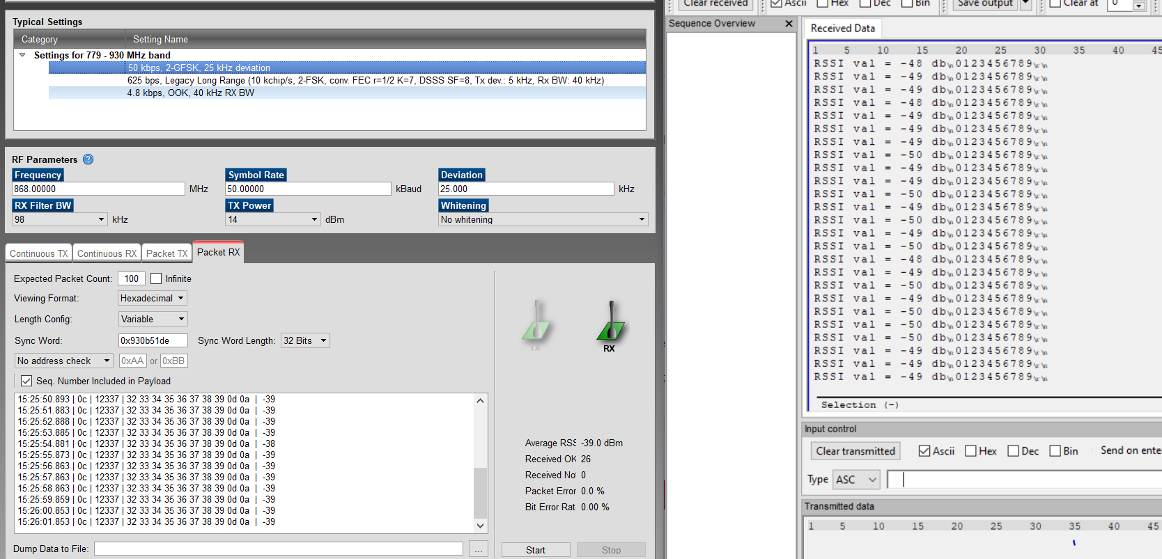

But When I put code on receiver custom board, the rssi value  that I see on the hterm is around -49dbm. You can see the results in the below picture.
According the results, The optimum rssi value that I am able to achieve is around -38 or -39 dbm. But I achieve -49 dbm.
What can I do to achieve optimum rssi value? or how to improve -49 dbm value.? Rf smartsetting file is also below.
