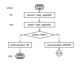

I have a custom board with CC1310, My project is using XDCtools [3.51.3.28_core] and SimpleLink CC13x0 SDK[4.10.1.01]. Today I want to make some spi communication with bma400 mems. I searched Sub-1 GHz forum and looked at the spimaster project and did something. But I am not sure if my communication is ok. If it is ok, why I can't see my slave's id ? Could you please suggest me to do something ?

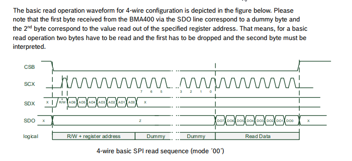

    txBuf[0] = 0x00;
    txBuf[1] = 0x00;
    transaction.count = 2;
    transaction.txBuf = txBuf;
//    transaction.rxBuf = NULL;
    transaction.rxBuf = rxBuf;
    transferOK = SPI_transfer(masterSpi, &transaction);

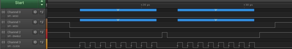

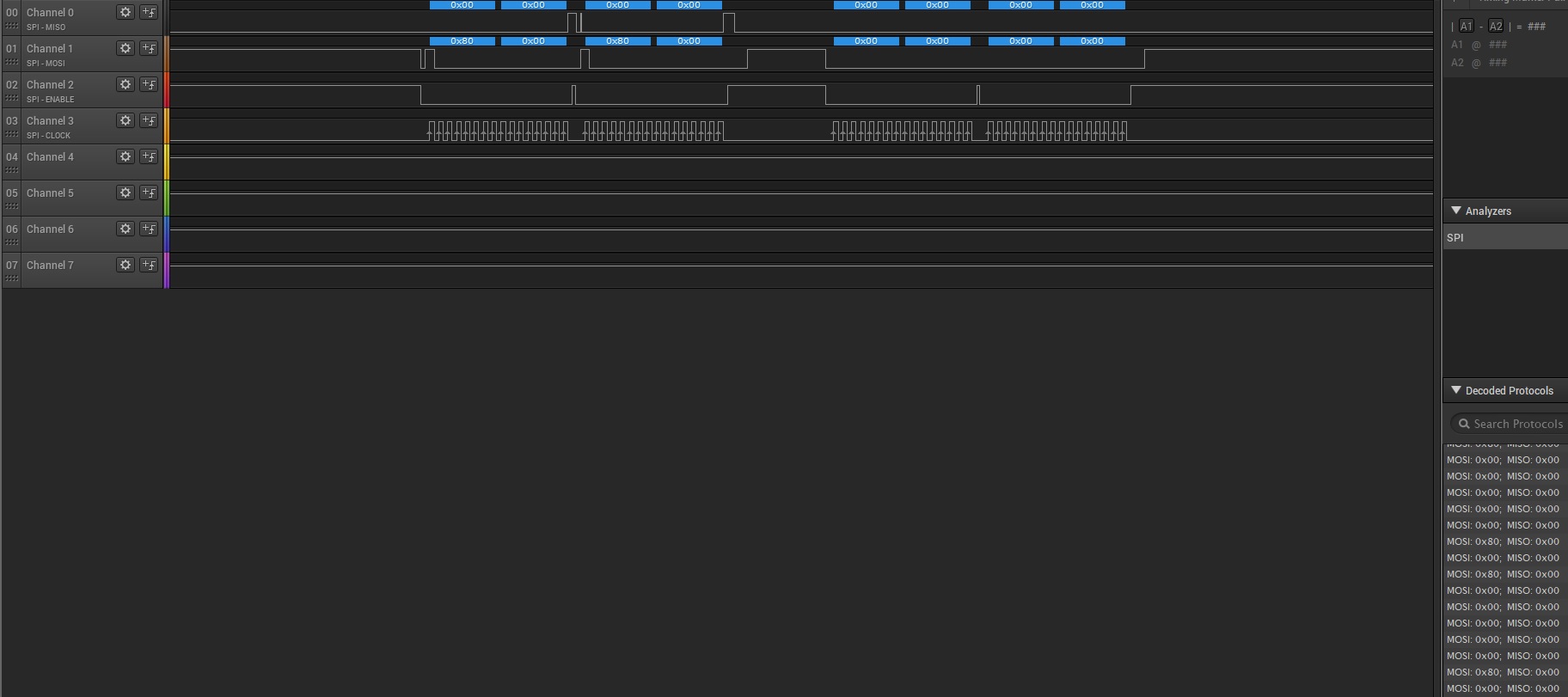

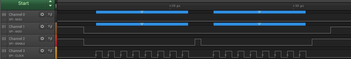

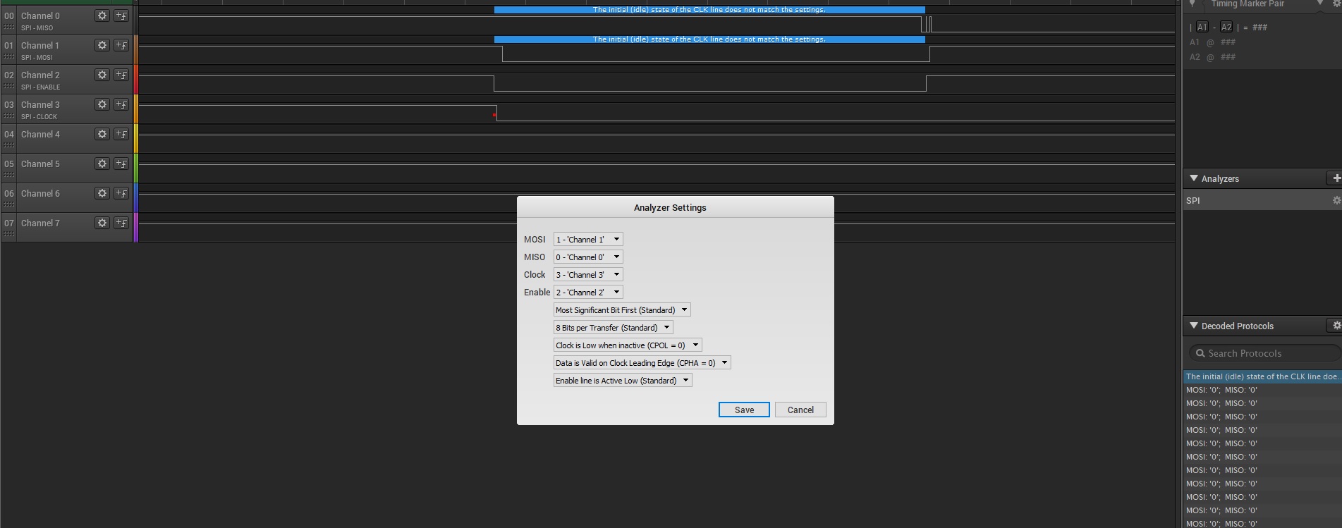

4 ) here is the logic analyzer output. I see a warning as below in first communication try.
and I send 0x00 0x00 to bma400 to read it's chip id. The answer is as below.
