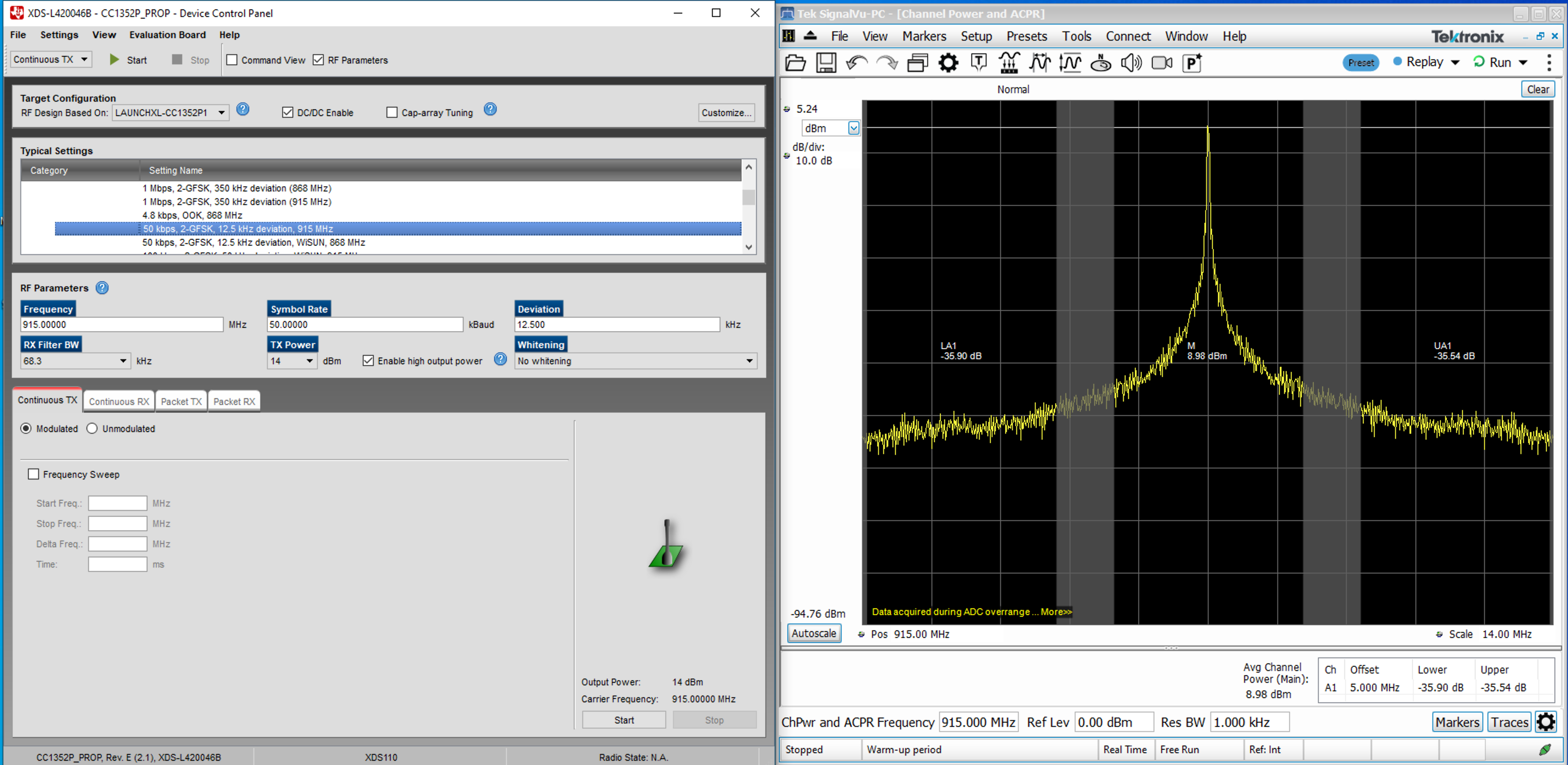

The conducted RF output power of the LAUNCHXL-CC1352P-1 is around 5dB low @ 915MHz.  Please let me know if there is anything that I can do to reduce this excessive insertion loss at this frequency.  The SP3T RF switch is rated for only 0.45dB,max insertion loss below 1GHz, so I'm not sure where the extra -4.5dB is coming from.  Please advise.  Thank you.
