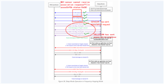

Hey guys,
I noticed one weird thing using FH mode. Sensor has SDK3.1 and collector uses SDK3.2 of collector/sensor example. When the sensor enters assocCnfCb() it sometimes returns the ApiMac_mlmeAssociateCnf_t *pData->status: 235.
It took me quite a while to reproduce this error. If I set ApiMac_mlmeSetReqBool(ApiMac_attribute_RxOnWhenIdle, true); before calling assocReq() I get the error. But if I put it to false I dont receive the error and the status is 0. However, on the collector side, the assocResp status is always 0.
So, why is this triggering the status error 235 although the collector always transmits an error status of 0?
best wishes
Slev1n
