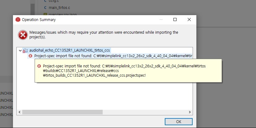

I am working on Audio Plugin using LAUNCHXL-CC1352R1.
SDK version is simplelink_cc13x2_26x2_sdk_4_40_00_44 and Auido Plugin version is 3.30.00.06
When I tried to import audio plugin I got the error like the attached image.
So I installed simplelink_cc13x2_26x2_sdk_3_30_00_03.
But I got the same error.
How to solve this problem?
I think after I uninstall simplelink_cc13x2_26x2_sdk_4_40_00_44, I want to install simplelink_cc13x2_26x2_sdk_3_30_00_03 and SimpleLink Audio Plugin 3.30.00.06 again.
But I don't know how to uninstall simplelink_cc13x2_26x2_sdk_4_40_00_44.
Please help me.

  • I found the reason for the error. A change has been done to the folder structure in the SDK. If you open the .projectspec for the example you are trying to import and change line 12 to
    <import spec="${COM_TI_SIMPLELINK_CC13X2_26X2_SDK_INSTALL_DIR}/kernel/tirtos/builds/cc13x2_cc26x2/release/ccs/tirtos_builds_cc13x2_cc26x2_release_ccs.projectspec"/>
    I can import.
    To have multiple SDKs installed should not cause an issue.

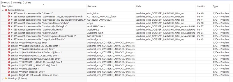

    Two projects were imported.
       1. audiohal_echo_CC1352R1_LAUNCHXL_tirtos_ccs
       2. tirtos_builds_CC1352R1_LAUNCHXL_release_ccs
    For the first project, build failed.
    The errors are

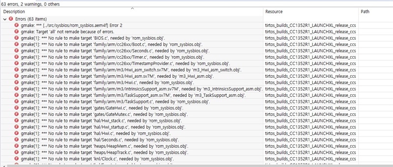

    Also, tirtos project build failed.
    This is the errors for tirtos build.

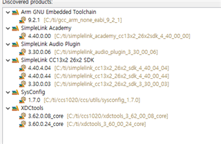

    This is the list for products.
    and the following is the resource variables:
    what is the SDK version and CCS version for audio plugin?
    Please how can I solve the build errors?

    I'm a bit surprised. I started from an empty workspace and imported the audiohal_echo example using CCS 10.1. I get two projects, audiohal_echo and tirtos_builds_cc13x2_cc26x2_release_ccs. If you don't get the latter, please post the .projspec file you changed.
    When I imported the audio project after I did the change posted above I had to go to Properties -> Build -> Dependencies and change the dependency to the tirtos project you have installed.
    It looks like the I2C drives has changed some so I had to comment out a line:
    const I2C_Config I2C_config[CC1352R1_LAUNCHXL_I2CCOUNT] = {
    // .fxnTablePtr = &I2CCC26XX_fxnTable,
    .object = &i2cCC26xxObjects[CC1352R1_LAUNCHXL_I2C0],
    .hwAttrs = &i2cCC26xxHWAttrs[CC1352R1_LAUNCHXL_I2C0]

    I am following your recommendations.
    I changed Dependencies form tirtos_builds_CC1352R1_LAUNCHXL_release_ccs to tirtos_builds_cc13x2_cc26x2_release_ccs_4_40_04_04.
    I found that I need to add some codes to tirtos due to dependencies change.
