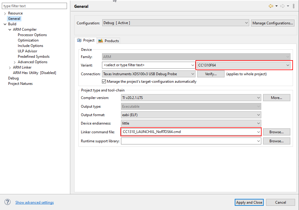

  • To convert a project from F128 to F32:
    The screenshots below is for a project I changed to F64. The same principle applies for F32.
    - Change the device variant to CC1310F32
    - Change the linker file. What I have found easiest is to open the linker file for F32 (select it in the "Linker Command File" pull-down.
    Change FLASH_SIZE and RAM_SIZE in the original link file found in the project with the values you found in the F32 linker file.
    Also remember to adjust the board files according to the pinout on your board: https://dev.ti.com/tirex/content/simplelink_cc13x0_sdk_4_10_01_01/docs/proprietary-rf/proprietary-rf-users-guide/proprietary-rf-guide/custom-hardware.html

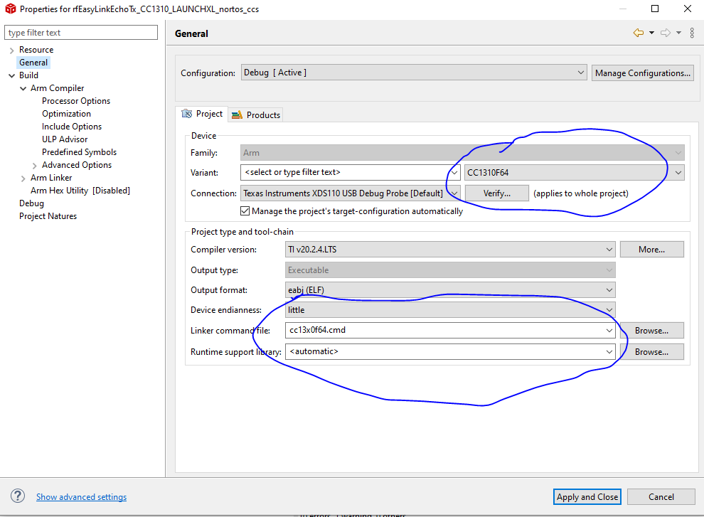

    when I change to F64, it is the same as F32. I do not have CC1310_LAUNCHXL_NoRTOS64.cmd file on list. Here is a settings:
    And I got the same error as with F32:
    "../cc13x0f64.cmd", line 79: error #10263: FLASH memory range has already been specified
    "../cc13x0f64.cmd", line 79: error #10264: FLASH memory range overlaps existing memory range FLASH
    "../cc13x0f64.cmd", line 81: error #10263: SRAM memory range has already been specified
    "../cc13x0f64.cmd", line 81: error #10264: SRAM memory range overlaps existing memory range SRAM

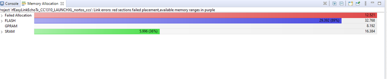

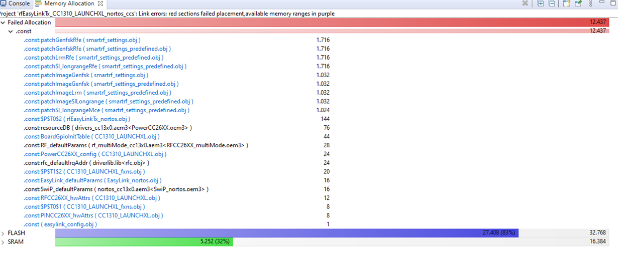

    "../CC1310_LAUNCHXL_NoRTOS.cmd", line 79: error #10099-D: program will not fit into available memory, or the section contains a call site that requires a trampoline that can't be generated for this section. placement with alignment fails for section ".const" size 0x30e9. Available memory ranges:
    FLASH size: 0x8000 unused: 0xf60 max hole: 0xf60

  • You should select F32 it you have this device flavor. F64 was just an example since I did this for a different customer.

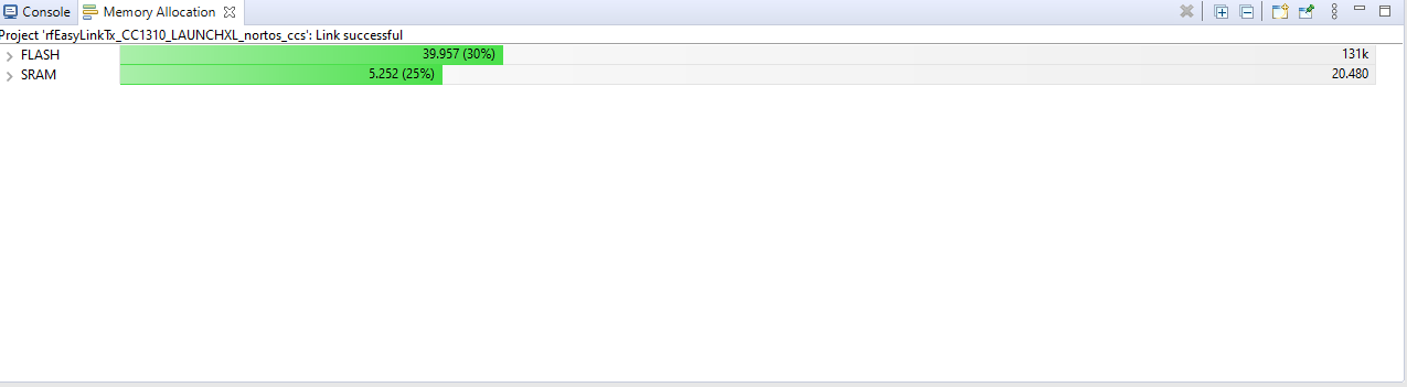

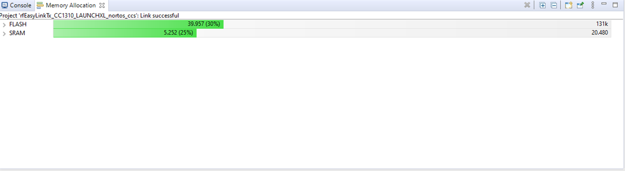

  • And, when I build it for F128, I see that he use almost 40k memory
  • Then it depends on how you have written the code. You can save some memory by removing all unused drivers etc as described in the link above. You probably need to analyze your code and see how much memory each part of the code require.

    I'm trying to compile basic example from TI site. When I look in memory usage (see picture) I do not know what to remove since this all is settings for RF.

  • - A noRTOS project will use more flash than a TIRTOS project since some of the functions for the later is placed in ROM. The packettx example then take up 26 kHz.
    - We provide development kits to make it easier to get start coding. When the application is close to done on the F128 device the memory allocation can be checked and from this it's possible to see if a F32, F64 or F128 device is needed.
    - As the examples show it's possible to fit a very simple application with RF into a F32 device.
