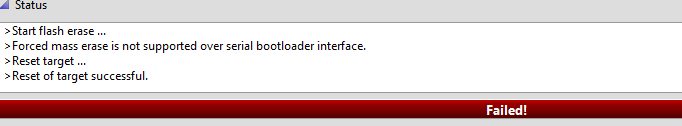

  • if i try to mass erase it is showing that error

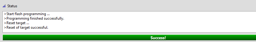

    if i try to play directly it is showing flashing program successful but in my code i have written blinking led it is not doing that

  • - You can not do mass erase over UART, this has to be done over JTAG.
    - As I understand it you actually manage to flash the chip over UART but you don't get the expected functionality after you have reseted the board. If you read out the flash using the JTAG interface, is the content of the flash the same as the .hex file you flashed the chip with?

    When we flash the .hex file in Smart RF Flash Programmer2, it shows successfully flashed.
    When we flash we are able to see the below status on the flash programmer:
    >Start flash programming ...
    >Programming finished successfully.
    >Reset target ...
    >Reset of target successful.
    This means it has entered into boot loader mode and flashed successfully. Isn't it?
    But we are not able to see the led blink (no response from controller we believe). What can be the reason. We are sure about the .hex file because when flashed using XDS it works. But when we flash using UART it doesn't.

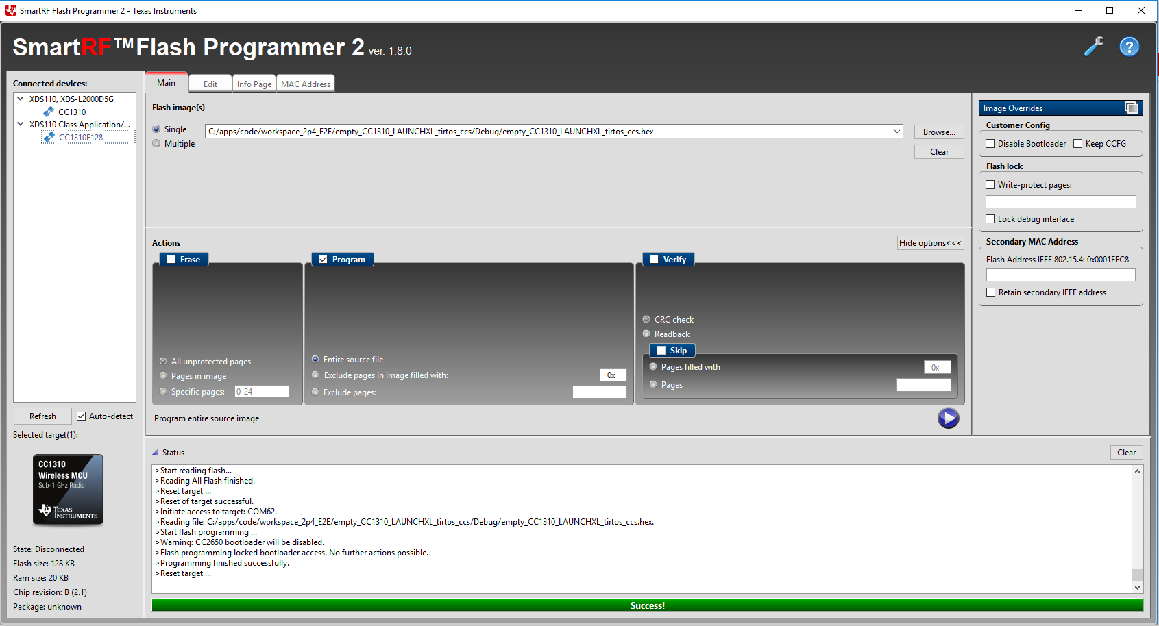

  • Try to use the following defines in ccfg
    #ifndef SET_CCFG_BL_CONFIG_BOOTLOADER_ENABLE
    //#define SET_CCFG_BL_CONFIG_BOOTLOADER_ENABLE 0x00 // Disable ROM boot loader
    #define SET_CCFG_BL_CONFIG_BOOTLOADER_ENABLE 0xC5 // Enable ROM boot loader
    #endif
    #ifndef SET_CCFG_BL_CONFIG_BL_LEVEL
    #define SET_CCFG_BL_CONFIG_BL_LEVEL 0x0 // Active low to open boot loader backdoor
    //#define SET_CCFG_BL_CONFIG_BL_LEVEL 0x1 // Active high to open boot loader backdoor
    #endif
    #ifndef SET_CCFG_BL_CONFIG_BL_PIN_NUMBER
    #define SET_CCFG_BL_CONFIG_BL_PIN_NUMBER 0x0D // DIO number for boot loader backdoor
    #endif
    #ifndef SET_CCFG_BL_CONFIG_BL_ENABLE
    #define SET_CCFG_BL_CONFIG_BL_ENABLE 0xC5 // Enabled boot loader backdoor
    //#define SET_CCFG_BL_CONFIG_BL_ENABLE 0xFF // Disabled boot loader backdoor
    #endif
    to press BTN-1(DIO_13) when you power on CC1310 to enter boot loader mode.
  • Thank you chen it is working fine now(i able to see led blinking)
