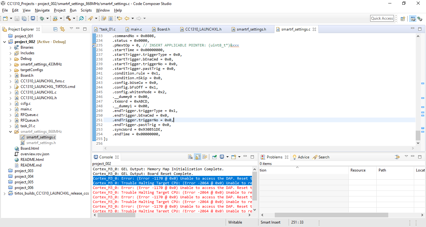

But when I use the same code in two custome boards for 433MHz, the code don´t work, the first TX (board A) and RX (board B) is OK but when the RX (Board B) try to TX I get these code in debugger
For 433MHz I use smartrf_sttings.c generated by SmartRF Studio

  • As I understand it you have two custom boards, board A and board B where the code works if board A uses action = 1 and board B uses action = 0 but if you set action = 0 and action = 1 you get an error message.
    The error you get does not seem to be related to the code as such since you get an error message indicating that you are not able to access DAP which is a JTAG error. Start by disconnecting the board, you can also do a restart of CCS, and try again.
  • Hi TER, my code normaly in run in two launchpad (915MHz) and don´t work in custome boards (433MHz):

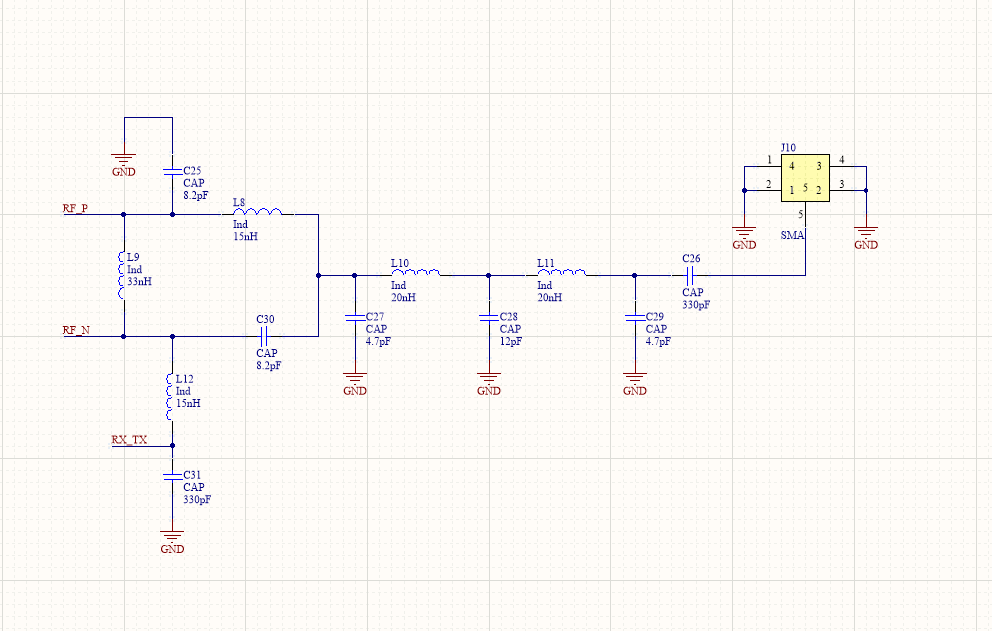

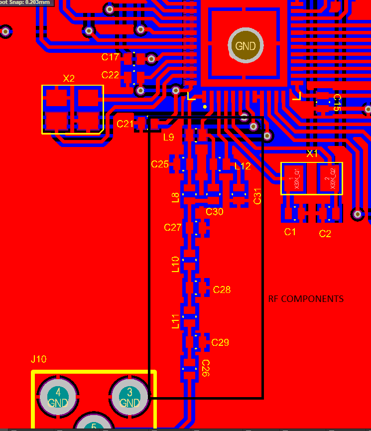

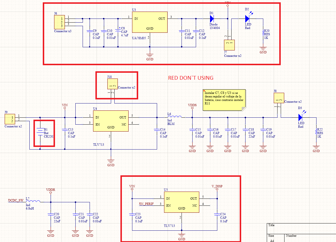

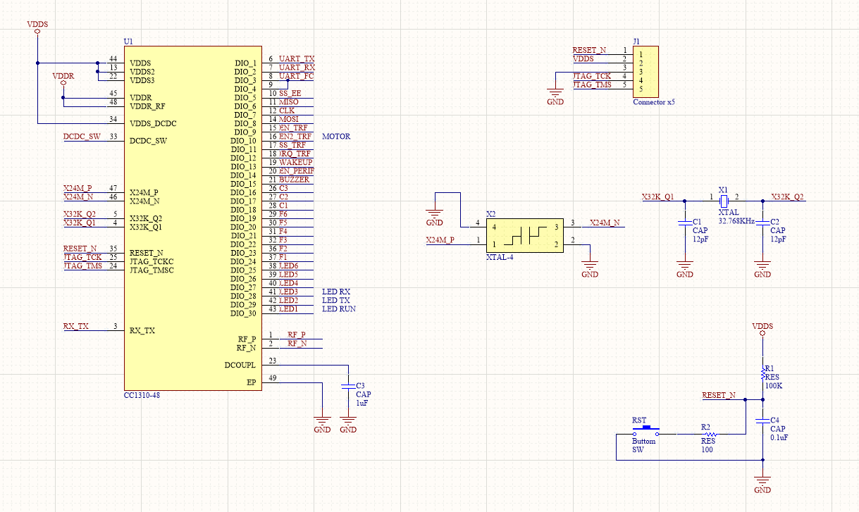

  • In this sequence, do you always get the error you posted in the first post and if yes, when?

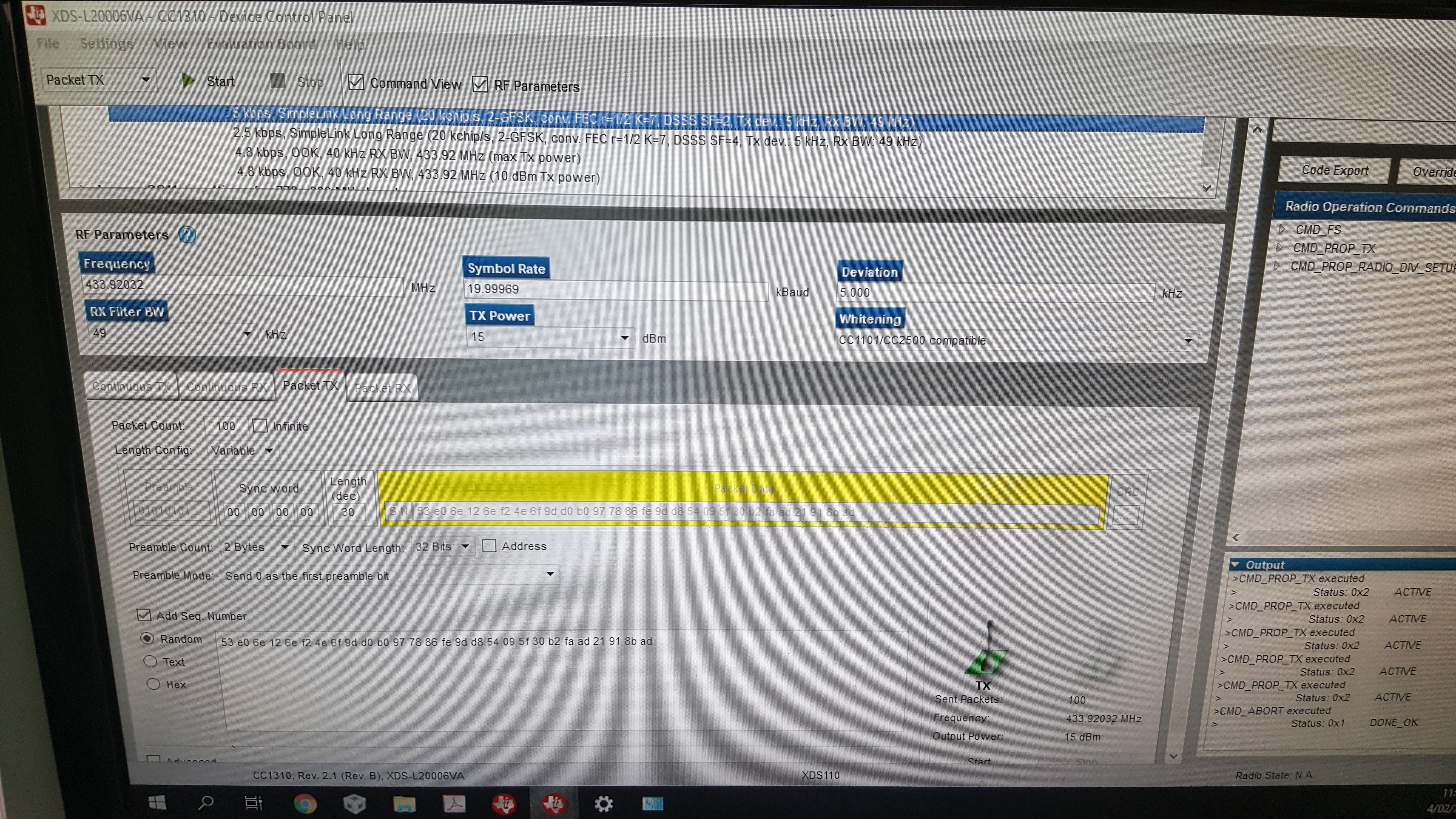

    Before starting to look at code etc, do you know that your custom boards work? Start by using SmartRF Studio to send/ receive packets between the boards. It's also easier to debug since you have more information than just a LED. Ideally you should first check the conducted performance, see www.ti.com/.../swra603.pdf
    Could you confirm that you are working with a rev B of CC1310? (SmartRF Studio reports the version)

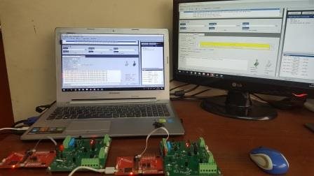

  • Hello TER, thank for your help.
    Board A (TX and switch to RX) -> Board B (RX), Board B get the frame, and switch to TX
    Board B tray to TX but I get the error show in CCS and without debugger I think board go to reset.
    If I reset Board A the Board B get the frame (I don´t any action in Board B).

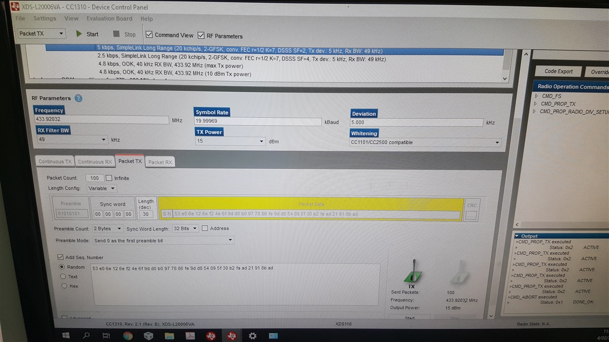

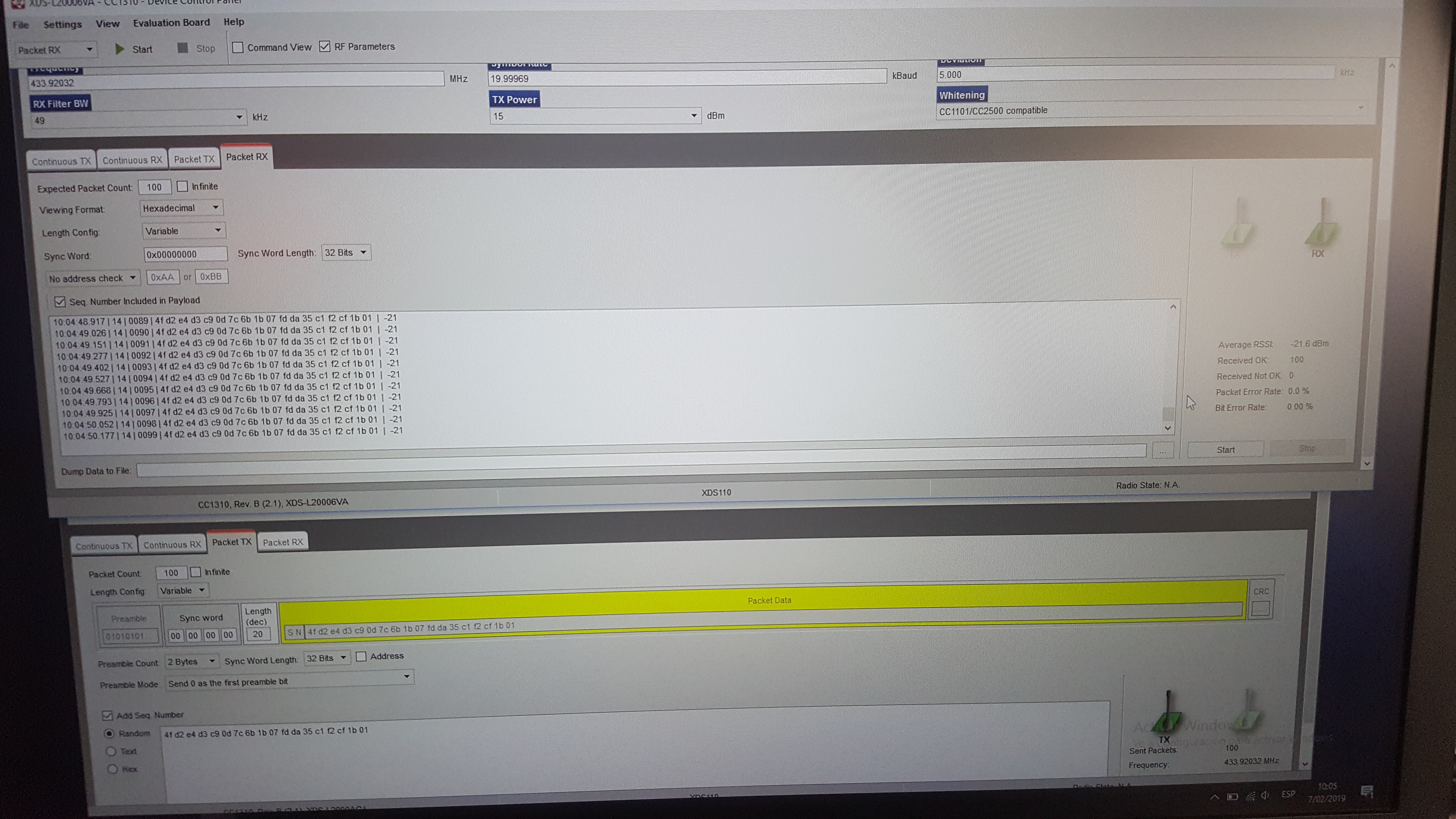

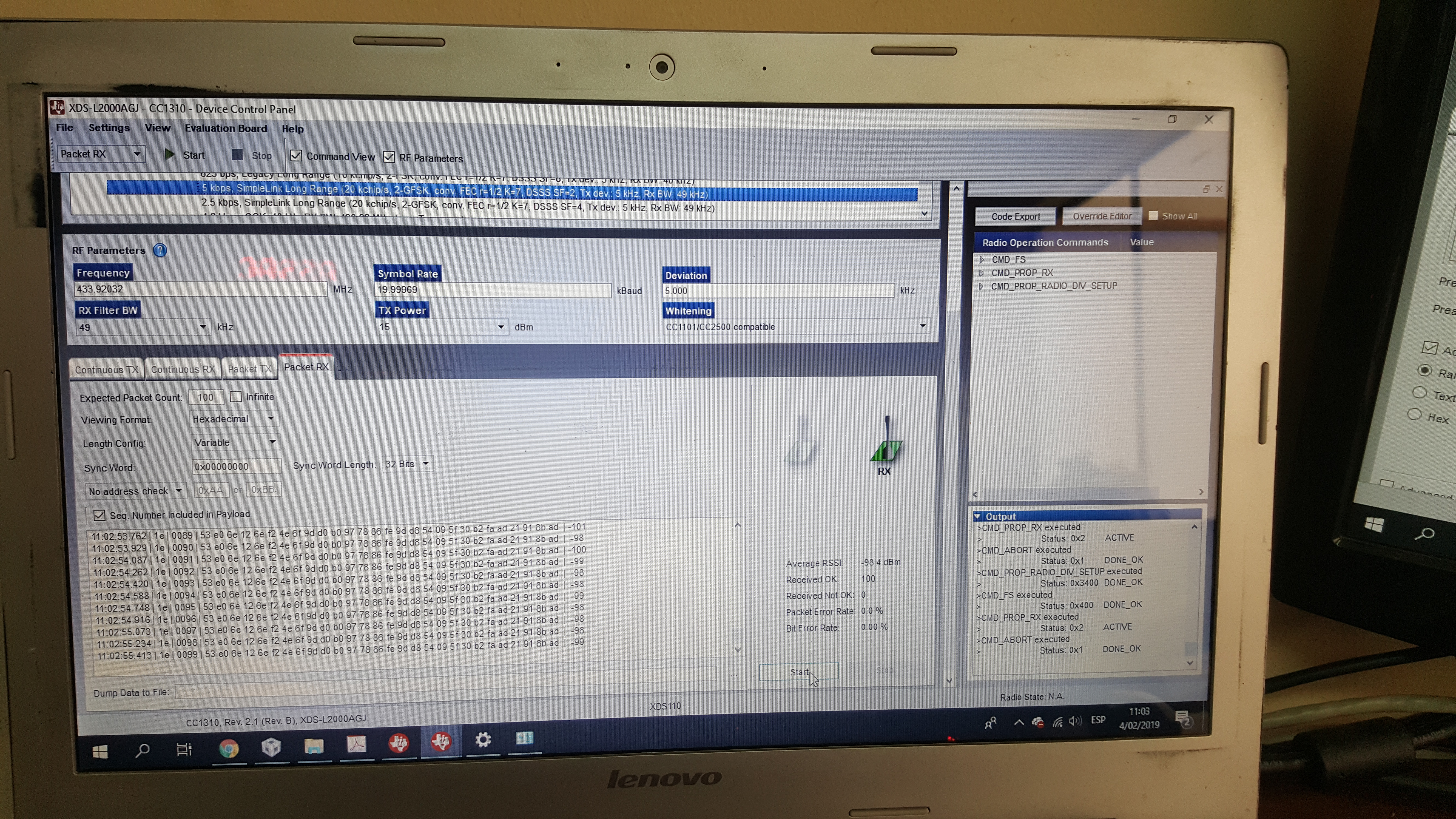

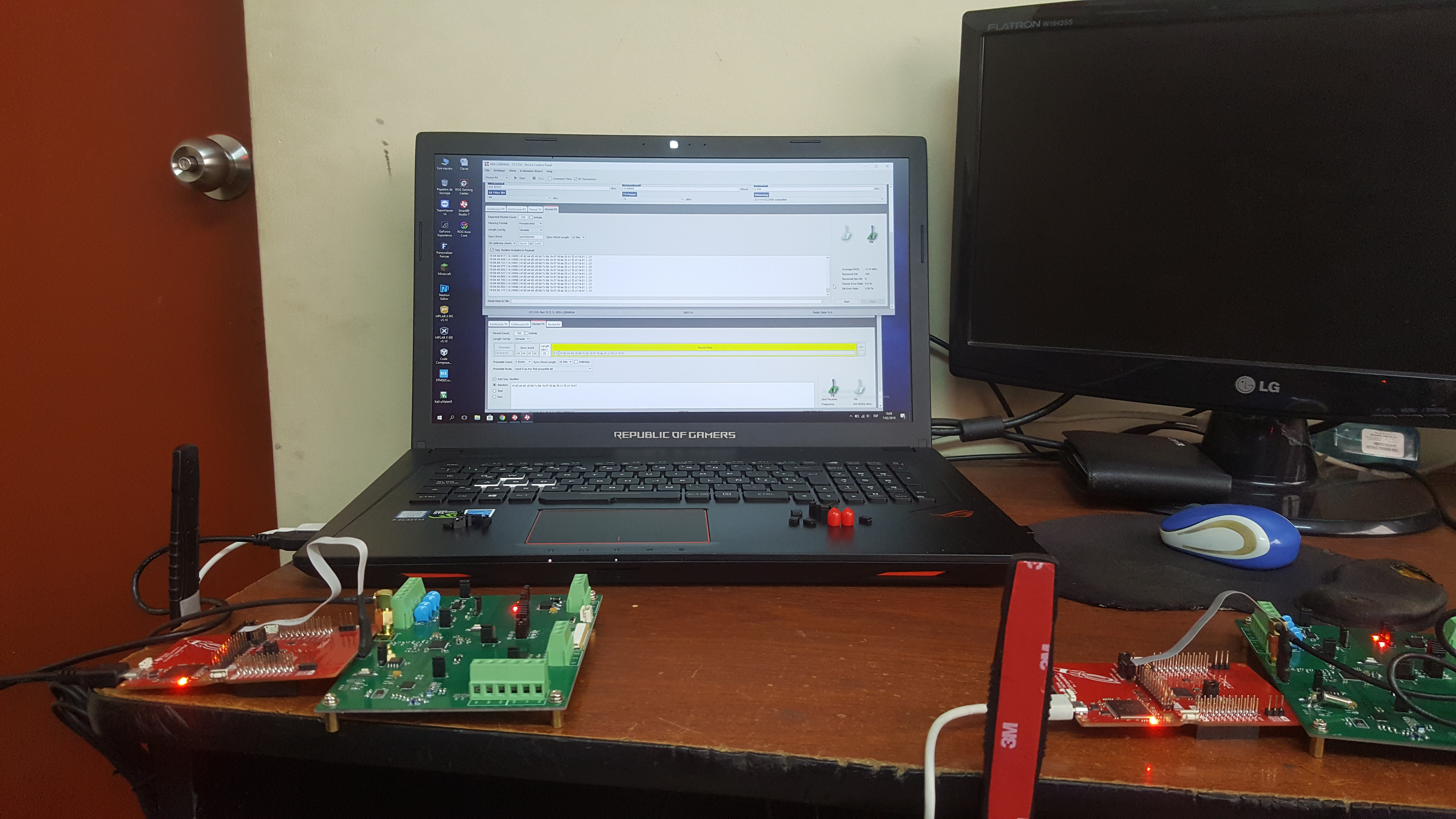

    This is the result of use SmartRF Studio, my CC1310 are rev. B
    In other test I get 15 CRC error messages.
    I attach my source code. Thanks.
    project.rar
  • Looking at the SmartRF studio test first: It looks like the two boards you use for testing are placed with less than 0.5 m distance. Why do you get as low RSSI as - 100 dBm at this distance?

  • Hello TER, in my last tets I don`t use any antenna whith my custom boards, I attach a test with boards with antennas and I get -21.6dbm and any CRC error message in many test, when I do this test with cc1310 launchpad I get -15dmb.
    When I use my code in my boards with antenna, I get the same error.
    I think boards are not the problem because these working with SmartRf Studio.
    I attached my source code. Thanks.3755.project.rar

  • Hello TER, sorry for delay.
    I  put my code with 433MHz settings on my launchpad and I don`t get any error.
    I put my code with 868MHz settings on my custom board and I get the same error.
    I attach my desing files
    Can I use the CC1350-433MHz rf settings on my CC1310 boardas?
    Thanks for your help.
  • If I understand the layout plot correctly you have one large via under the RF chip and no vias around the balun/ filter part.
    If that is the case you most likely get some strange issues due to poor layout. Please follow the reference design layout.
  • Hi TER, I will improve the pcb in the next design, thanks.
    But when I use the SmartRF Studio to test my boards can TX or RX one at time.
    I will try to use the echoTX / echoRX examples.
