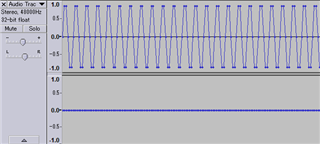

I receive data through I2S interface but data at left channel somtimes change from i2s_af_buff to i2s_af_buff2 when I restart I2S.
How can I fixed left channel data at i2s_af_buff and right channel data at i2s_af_buff2 ?

    One more clarification, in your first post you show a screenshot of Audacity, where it seems like the left channel has twice as much data as expected while the right channel has no data. Is this what you see from the I2S buffers?
    I think overall, the I2S interface is not expected to be repeatedly stopped/restarted. If you perform a soft MCU reset using the code in this linked post, are you able to get the expected I2S functionality back?
