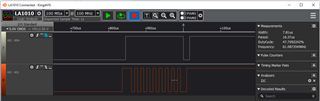

  • I have measured timing of UtilsDelay().
    UtilsDelay(0) never returns. I understand that it is not possible to check 0 in runtime inside of this function, this is ok.
    UtilsDelay(1) used in code above gave about 8us.
    UtilsDelay(3) used in code above gave about 8us.
    UtilsDelay(30): used in code above gave about 10us.
    For info: gpio_set() in code above calls directly GPIO_write(). I haven't used GPIO_setConfig() as in my case is I2C not yet configured/activated.
    I have tried to disable interrupts using pair HwiP_disable() / HwiP_restore() around the whole function with similar results.
    Next measurements:
    UtilsDelay(300)   >> cca 53us
    UtilsDelay(3000) >> cca 457us
    When calling GPIOPinWrite() directly instead of GPIO_write()
    UtilsDelay(3) used in code above gave about 2.25us
    When ASSERT(GPIOBaseValid(ulPort)); is disabled in GPIOPinWrite() ( running on DEBUG )
    UtilsDelay(1) used in code above gave about 1.00us
    UtilsDelay(3) used in code above gave about 1.29us     // UtilsDelay(1) ~ 0.43us
    UtilsDelay(30) used in code above gave about 3.2us     // UtilsDelay(1) ~ 0.11us
    UtilsDelay(300) used in code above gave about 46us    // UtilsDelay(1) ~ 0.15us
    UtilsDelay(3000) used in code above gave about 451us // UtilsDelay(1) ~ 0.15us
    UtilsDelay(30000) used in code above gave about 4.5m// UtilsDelay(1~ 0.15us
    UtilsDelay(300000) used in code above gave about 22.5m/UtilsDelay(1) ~ 75ns
    The measurements above (which eliminated overheads) are giving 150ns / 75ns which looks to be similar to issue reported here:
    https://e2e.ti.com/support/wireless-connectivity/wi-fi-group/wifi/f/wi-fi-forum/1003724/cc3200mod-utilsdelay-is-not-giving-precise-delay-in-cc3200-cc3220sf
    For my needs I have something that I can use - UtilsDelay(5) (I want to generate I2C "bus clear" with similar clock speed as regularly used cca 386kHz - should be actually 400kHz, some feature/bug of CC3220MODASF?).
  • I believe the timing is correct and the 75ns (which is double of expected) is caused just be measurement. As for pin toggling I need at least 1 instruction. ;-)
