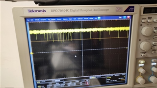

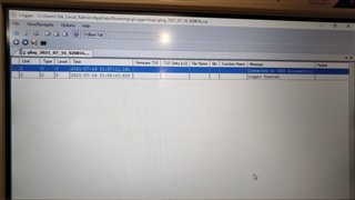

WL1837MOD: WLAN gLogger unable to receive or store the firmware logs
Part Number: WL1837MOD

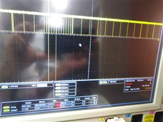

We need to take the logs while WLAN in continuous TX . We have connected Debug pin of the WLAN to serial to usb converter to windows machine. gLogger able to connect to the wlan over the WLAN. The csv log file is attached for your reference. But we dont see any firmware logs further with gLogger. But the communication is fine as shown the attached screen shots from oscilloscope.
