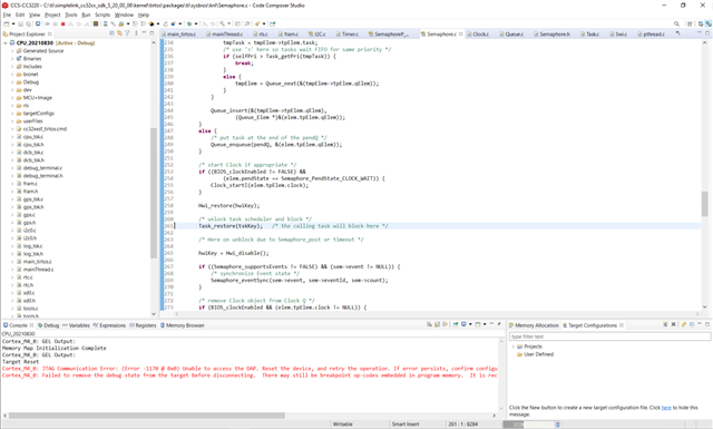

Hello support team.
I'm having a problem debugging with XDS110 and CC3220SF.
My application runs in "MCU + Image" configuration, but in "Debug" mode it's giving the message below:
Cortex_M4_0: JTAG Communication Error: (Error -1170 @ 0x0) Unable to access the DAP. Reset the device, and retry the operation. If error persists, confirm configuration, power-cycle the board, and/or try more reliable JTAG settings (e.g. lower TCLK). (Emulation package 9.3.0.00058)
Cortex_M4_0: Failed to remove the debug state from the target before disconnecting. There may still be breakpoint op-codes embedded in program memory. It is recommended that you reset the emulator before you connect and reload your program before you continue debugging
I've restarted the target, the debugger and my computer several times, but the same problem always occurs.
The Code Composer Studio version I'm using is 10.3.1.00003;
The SimpleLink CC32xx SDK version is 5.10.0.02.
Thank you.

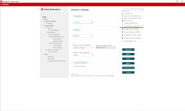

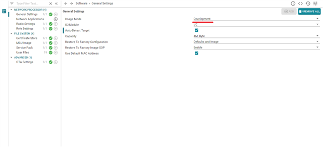

  • Thank you so much Seong.
    My project is already in development mode, as shown below.
    I can load the program and run it to the point where that error message pops up.
    Thank you for the response.

  • Hi Jan, thank you very much for the reply.
    I accessed the device through Uniflash to confirm the current mode. It is indicating that it is in development mode.
    What am I doing wrong?

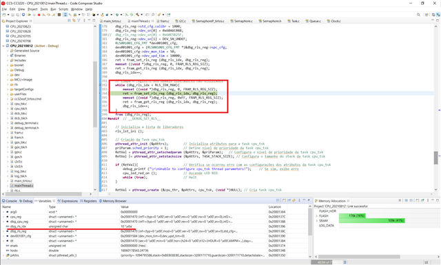

    In my tests, the error message happens inside a loop, where I do reads and writes to an I2C FRAM memory, see figure 1. In this figure, you can see that the loop control variable "dbg_rls_idx", you can see that the loop has already run 10 times. Sometimes the problem manifests itself in turn number 9.
    I tried commenting the loop and noticed that the message happens later. I don't believe it's an error in the application code, as the message comes up at different points, as if some JTAG resource ran out. When I run the same code without the JTAG, writing the image in CC3220, everything seems to work fine. I need JTAG as I want to debug new functionality.

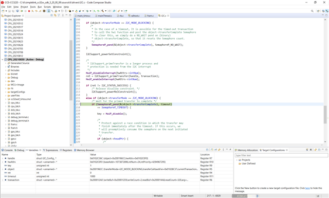

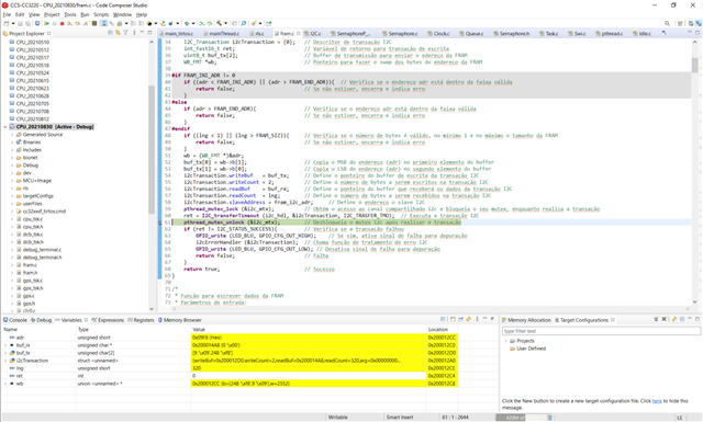

    I ran the code step by step to try to figure out the exact code point that the JTAG crash.
    Figure 1 shows the call to the I2C_transferTimeout function;
    The I2C_transferTimeout function executes correctly until reaching the line indicated in figure 2;
    Within the SemaphoreP_pend function figure 3, the Semaphore_pend function is called, where I managed to reach the line indicated in figure 4;
    When I run the Task_restore function by pressing F6 (step over) the debug crash as shown in Figure 5;
    Running Task_restore with F5 (step into), I can get to the Idle_loop function, seen in Figure 6;
    In the Idle_loop function the step-by-step execution seems to get stuck in the wait loop, I tried putting a break point in the line below the I2C_transferTimeout function and pressed Resume, surprisingly it ran and stopped correctly, as shown in figure 7.
    Figure 1.
    Figure 2.
    Figure 3.
    Figure 4.
    Figure 5.
    Figure 6.
    Figure 7.
    I don't know if this test helps anything, but if you can give me any more tips to solve my problem, I'm grateful.

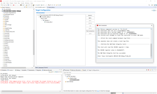

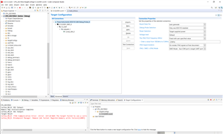

    I initially ran the tests with default TCLK which seems to be 5.5 MHz, see figure 1.
    I lowered the TCLK speed to 2.5 MHz, as shown in figure 2, but it didn't work.

  • Sorry Seong, I confused you with Jan.
    I'll take the opportunity and pass on the message of the JTAG connection test:
    [Start: Texas Instruments XDS110 USB Debug Probe]
    Execute the command:
    %ccs_base%/common/uscif/dbgjtag -f %boarddatafile% -rv -o -S integrity
    [Result]
    -----[Print the board config pathname(s)]------------------------------------
    C:\Users\carlo\AppData\Local\TEXASI~1\CCS\
    ccs1040\0\0\BrdDat\testBoard.dat
    -----[Print the reset-command software log-file]-----------------------------
    This utility has selected a 100- or 510-class product.
    This utility will load the adapter 'jioxds110.dll'.
    The library build date was 'Jun 25 2021'.
    The library build time was '11:45:30'.
    The library package version is '9.4.0.00129'.
    The library component version is '35.35.0.0'.
    The controller does not use a programmable FPGA.
    The controller has a version number of '5' (0x00000005).
    The controller has an insertion length of '0' (0x00000000).
    This utility will attempt to reset the controller.
    This utility has successfully reset the controller.
    -----[Print the reset-command hardware log-file]-----------------------------
    The scan-path will be reset by toggling the JTAG TRST signal.
    The controller is the XDS110 with USB interface.
    The link from controller to target is direct (without cable).
    The software is configured for XDS110 features.
    The controller cannot monitor the value on the EMU[0] pin.
    The controller cannot monitor the value on the EMU[1] pin.
    The controller cannot control the timing on output pins.
    The controller cannot control the timing on input pins.
    The scan-path link-delay has been set to exactly '0' (0x0000).
    -----[Perform the Integrity scan-test on the JTAG IR]------------------------
    This test will use blocks of 64 32-bit words.
    This test will be applied just once.
    Do a test using 0xFFFFFFFF.
    Scan tests: 1, skipped: 0, failed: 0
    Do a test using 0x00000000.
    Scan tests: 2, skipped: 0, failed: 0
    Do a test using 0xFE03E0E2.
    Scan tests: 3, skipped: 0, failed: 0
    Do a test using 0x01FC1F1D.
    Scan tests: 4, skipped: 0, failed: 0
    Do a test using 0x5533CCAA.
    Scan tests: 5, skipped: 0, failed: 0
    Do a test using 0xAACC3355.
    Scan tests: 6, skipped: 0, failed: 0
    All of the values were scanned correctly.
    The JTAG IR Integrity scan-test has succeeded.
    -----[Perform the Integrity scan-test on the JTAG DR]------------------------
    The JTAG DR Integrity scan-test has succeeded.
    [End: Texas Instruments XDS110 USB Debug Probe]

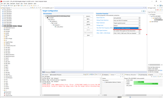

    I did the tests changing the debug interface to SWD.
    As shown in Figure 1, error -615 occurred:
    Cortex_M4_0: JTAG Communication Error: (Error -615 @ 0x0) The target failed to see a correctly formatted SWD header. The connection to the target may be unreliable. Try lowering the TCLK setting before trying again. (Emulation package 9.4.0.00129)
    Cortex_M4_0: Breakpoint Manager: Remove job failed: Register/memory write failure[22005]
    I tried reducing TCLK to 2.5 MHz, but the same problem occurred as shown in figure 2.
    I also tested it with 1.0 MHz TCLK, but it didn't work either, as shown in figure 3.
    I ran the program step-by-step and verified that the execution progressed a little, the problem arose a little further in relation to the 4-wire JTAG test, but the problem is still with the call to the I2C_transferTimeout function, as shown in Figure 4.

    I noticed that on my hardware, the SW2 equivalent pin ends up being active and so it has the same errors as the LaunchPad.
    Can the OOB example run in Debug mode?
    Could you test the OOB example in Debug mode and tell me if pressing SW2 also gives an error?
    Regarding the question about energy saving, I didn't add anything regarding that. I believe that is not the problem.
    And regarding the I2C_transferTimeout function, is it just a coincidence?
    Thank you very much.
    At my computer I have installed old CCS version (8.3.1) and from this reason I cannot run OOB example right now because this example uses Sysconfig. I have quickly check source code of OOB example from 5.20 SDK. When is SW2 pressed at OOB example, device is switched into AP mode and rebooted. In this state can be loosing of JTAG connection expected. Before JTAG connection lost at OOB you can expect at log ... "[Control task] device started in AP role, rebooting device...".
    If you want, you can deactivate function of SW2 by commeting message queue inside handler pushButtonInterruptHandler2().
    I am not able to say what is connection between I2C and JTAG disconnection at your case. If this is just coincidence or there is some hardware or software connection.
