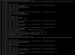

  • I have captured the wlan_irq line, sdio clock and one data bit just before entering the suspend state (right cursor in logic analyzer waveform).
    I have noticed that the wlan_irq line is going high 33ms before entering the suspend state, and staying high during the hanged situation. This is observed twice now.
    wlan-suspend-entry-that-will-hang.pdf
    Trond
  • Thanks for this post Trond. I am using a beaglebone black as STA and have experienced the hanging. I will report this issue internally.
  • Nice that you could reproduce.
    I saved a logic analyzer waveform showing the hang resolution by a button press wake.
    wlan-suspend-hang-resolved-by-button-wake.pdf
    This was after hanging through 6 hours over the night - the communication resumed by the button press wake.
    I will be available for testing / debugging if that can speed up finding a fix for this issue.
    Trond

    I have noticed that the PM module seems to be blocking the driver. Note these logs in the image attached. My secondary wakeup source is UART. The driver kicks in and handles the interrupt. Can you confirm something similar on your end?
    You can enable DEBUG_IRQ via:
    $ echo 8 > /proc/sys/kernel/printk
    $ echo 1 > /sys/module/wlcore/parameters/debug_level
  • Hi Sabeeh,
    I do not understand what is wrong with the kernel logging you are showing - it looks like it should be from my perspective.
    Trond

  • If I understand correctly, the crash only occurs if BT is enabled? If you were to remove your workarounds and start fresh, does the WoWLAN atleast function correctly with the added command to suspend? How are you enabling BT? BT and wlcore are separated and should not be causing a crash, unless you have mapped GPIO incorrectly.
    As for the cat wakeup_count > wakeup_count command, it is critical that the same value read from the wakeup_count is the same and is being written back to the wakeup_count.
  • Hi Sabbeh,
    We are running thousands of state transitions to and from suspend automatically on multiple systems.
    Lately I saw a 3rd issue with the WLAN module:
    Nov 16 04:21:02 gm400-rev05-mx7 user.info kernel: [ 6511.462774] Filesystems sync: 0.589 seconds
    Nov 16 04:21:02 gm400-rev05-mx7 user.info kernel: [ 6511.467434] Freezing user space processes ... (elapsed 0.001 seconds) done.
    Nov 16 04:21:02 gm400-rev05-mx7 user.info kernel: [ 6511.476067] OOM killer disabled.
    Nov 16 04:21:02 gm400-rev05-mx7 user.info kernel: [ 6511.479359] Freezing remaining freezable tasks ... (elapsed 0.001 seconds) done.
    Nov 16 04:21:02 gm400-rev05-mx7 user.info kernel: [ 6511.487935] printk: Suspending console(s) (use no_console_suspend to debug)
    Nov 16 04:21:02 gm400-rev05-mx7 user.warn kernel: [ 6512.008893] wlcore: WARNING ELP wakeup timeout!
    Nov 16 04:21:02 gm400-rev05-mx7 user.warn kernel: [ 6512.008901] queueing ieee80211 work while going to suspend
    Nov 16 04:21:02 gm400-rev05-mx7 user.warn kernel: [ 6512.008913] wlcore: WARNING CONFIGURE command NOK
    Nov 16 04:21:02 gm400-rev05-mx7 user.warn kernel: [ 6512.008920] wlcore: WARNING failed to set beacon filter opt: -5
    Nov 16 04:21:02 gm400-rev05-mx7 user.warn kernel: [ 6512.008924] wlcore: WARNING couldn't prepare device to suspend
    Nov 16 04:21:02 gm400-rev05-mx7 user.err kernel: [ 6512.009196] PM: dpm_run_callback(): wiphy_suspend+0x0/0x190 [cfg80211] returns -5
    Nov 16 04:21:02 gm400-rev05-mx7 user.err kernel: [ 6512.009211] PM: Device phy0 failed to suspend async: error -5
    Nov 16 04:21:02 gm400-rev05-mx7 user.err kernel: [ 6512.009233] PM: Some devices failed to suspend, or early wake event detected
    Nov 16 04:21:02 gm400-rev05-mx7 user.info kernel: [ 6512.057095] OOM killer enabled.
    Nov 16 04:21:02 gm400-rev05-mx7 user.info kernel: [ 6512.060254] Restarting tasks ... done.
    Nov 16 04:21:02 gm400-rev05-mx7 user.info kernel: [ 6512.065203] PM: suspend exit
    Nov 16 04:21:14 gm400-rev05-mx7 user.err kernel: [ 6524.600947] p2p-wlan0-0: failed to remove key (0, 18:65:90:d4:53:25) from hardware (-11)
    Nov 16 04:21:14 gm400-rev05-mx7 user.info kernel: [ 6524.611922] p2p-wlan0-0: HW problem - can not stop rx aggregation for 18:65:90:d4:53:25 tid 1
    Nov 16 04:21:14 gm400-rev05-mx7 user.err kernel: [ 6524.621198] p2p-wlan0-0: failed to remove key (1, ff:ff:ff:ff:ff:ff) from hardware (-11)
    Nov 16 04:21:15 gm400-rev05-mx7 user.warn kernel: [ 6525.148873] wlcore: WARNING Unable to flush all TX buffers, timed out (timeout 500 ms
    Nov 16 04:21:15 gm400-rev05-mx7 user.info kernel: [ 6525.231261] wlcore: down
    Nov 16 04:21:15 gm400-rev05-mx7 user.warn kernel: [ 6525.233844] wlcore: WARNING CONFIGURE command NOK
    Nov 16 04:21:15 gm400-rev05-mx7 user.warn kernel: [ 6525.238646] wlcore: WARNING failed to set acx_event_mbox_mask: -5
    Nov 16 04:21:15 gm400-rev05-mx7 user.warn kernel: [ 6525.245177] wlcore: WARNING CONFIGURE command NOK
    Nov 16 04:21:15 gm400-rev05-mx7 user.err kernel: [ 6525.250100] wlcore: ERROR could not configure sleep_auth to 2: -5
    Nov 16 04:21:15 gm400-rev05-mx7 user.info kernel: [ 6525.409237] wlcore: down
    This also requires a complete reboot to be resolved.
    Trond
  • Please help me understand how all of these errors are occuring. Is the device in AP or STA? Are you using 2.4 or 5Ghz? Explanations of what is going on would be helpful as I'm no longer able to reproduce any of these scenarios after my previous suggestion.
  • Hi Sabeeh,
    The above error is happening regardless of BT enabled or not. I just let the WLAN mode in idle, meaning no connection is established - the poff!
    Trond
  • Hi Sabeeh,
    I have been deep-diving into the wlcore kernel driver code lately and luckily found a resolution of the issue after doing some debugging.
    This simple patch was all it took:
    diff --git a/drivers/net/wireless/ti/wlcore/main.c b/drivers/net/wireless/ti/wlcore/main.c
    index 547ad538d8b6..6ecd61eebf77 100644
