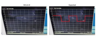

I use Hcitool for BT/BE tests. The test lab in Korea is asking to perform CW Tx with 50% duty cycle. Currently I am able to transmit with 100% duty. I couldn't find a way to control this. Could you please help ?
I have attached a picture that was sent by the test lab.
