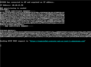

Hello. I am following this guide on provisioning my CC3235S with AWS using AWS SDK plugin.
I am using the subscribe_publish_sample project straight from Resource Explorer for CC3235S, TIRTOS, and CCS Compiler found here.
I am using latest SI SDK (5.20.00.06), latest AWS Plugin (4.30.00.02), and have the latest Service Pack installed (4.11.0.0).
I am unable to complete my HTTP POST request. Inside sendCSR(), I successfully create the HTTP client, but I am getting -111 Connection Refused error returned by HTTPClient_connect. I understand that one of the arguments for this function is the DEFINE I updated called AWS_IOT_PROVISIONING_HOST. This is a possible source of error, but when the terminal reads “Sending POST HTTP Request to <URL >, that makes sense to me.
My understanding is that this is the API Gateway invoke URL, but I could be wrong. The guide and comments from TI do a poor job of explaining things.
I am getting socket-related errors. When
 ret = SlNetSock_startSec(cli->ssock, secAttribs, SLNETSOCK_SEC_START_SECURITY_SESSION_ONLY | SLNETSOCK_SEC_BIND_CONTEXT_ONLY);
Is called inside HTTPClient_connect2, which is inside HTTPClient_connect, the program hangs forever at:

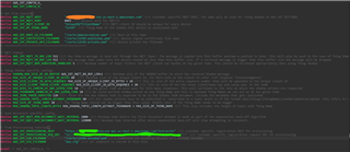

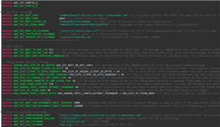

  • Filled in aws_iot_config.h to the best of my abilities (possible source of error)
  • Flashed Certificates onto device and verified correct filepath in aws_iot_config.h DEFINEs
  • Tried different variations of URL for POST Request.
  • Increased the HTTP Client Buffer stack size as instructed in the AWS Provision Guide
My code is the entire project straight from Resource Explorer. I will however share my aws_iot_config.h file:
I do not know exactly what my Request URI is, but I am using the URI for the lambda I'm using to provision.

  • Hi Tom,
    Take another look at your AWS_IOT_PROVISIONING_HOST and REQ_URI and compare it to the code block comments in task 6, step 2 of the tutorial. It looks like those defines are expecting /Test/proto in a different place.
    Also, in your application, are you using your real device's UDID for MY_THING_NAME?

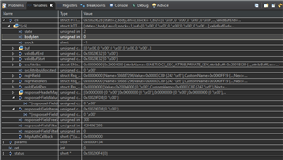

    NOTE: I also wanted to add that When I use HTTP instead of HTTPS, I get the same error, but my program does not get the DRIVER ABORTED type of errors, it just fails the process and keeps moving on.
    NOTE: I checked out the HTTP Client handle, and the expressions view just gave me a memory location for the client handle. I used memory browser to view the memory, but didn't make out anything significant. Here is cli which is being returned by HTTPClient_Create. Status is returned 0 which is good, but something doesn't add up. I was looking at HTTPClient_CB. This appears all over httpclient.c, but it has no definition. I cannot find its initialization. It seems to be a struct, but I cannot find it. Is this significant?

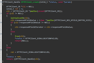

    I am questioning if my HTTPCreate_client function is failing even though it's not returning any errors. I can never see what my HTTPClient_Create function returns. It is as if it is a TI driver structure, but I cannot find a declaration for HTTPClient_Handle or HTTPClient_CB. I'm guessing they are hidden structs, but I made sure httpclient.h was included just to be sure.
    I can't help but to think that the biggest clue here is the difference in result between using HTTP and HTTPS for my POST Request URL.
    What event handler are you referring to? In the terminal, the last thing printed is:
    If there is some logging I need to be doing, can you please instruct me on how to do it? I'm not sure if you mean terminal log I've screenshot above or some other log.

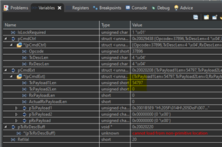

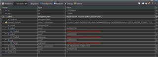

    I really dove into the weeds. The FATAL_DRIVER_ERROR occurs when a TxPayload Is being written to the NetWork Processor. The function _SlDrvMsgWrite occurs several time, usually with a reasonable payload. However, during the function sl_SetSockOpt which is called inside SlNetlfWifi_sockstartSec, _SlDrvMsgWrite encounters a TxPayload that has a length of 54,797 bytes. I'm not yet sure where this payload is coming from, but the TxPayload is breaking my program. This is the cause of death.

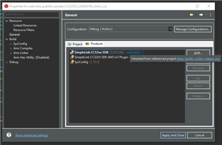

    The AWS plugin was tested when it last released with the CC32xx SDK 4.30, so there's potential for an issue with the recent 5.20 SDK. I'm still working on reproducing the issue. I can update you tomorrow.

  • Sarah, would you mind helping me with my Private Key question earlier? This may not be a compatibility/driver issue, not sure yet. I apologize for overloading this thread with info, but I believe I've boiled it down to my SecurityAttributes possibly being an issue.
    I've determined that the 54,797 byte value is my secAttribute for my " PRIVATE_KEY ". Should my private key be this long? This is ultimately what is breaking my program. My problem revolves around my ignorance of the private key as a whole.

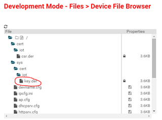

    When you generate a CSR, the device private key is added to the file system as a secure file in the location provided in the lab (/sys/cert/iot/key.der). This seems like the confusion and why the demo is failing. This private key file is only readable by the network processor, but you can check the file exists using the filesystem APIs or the Online User Files button in UniFlash ImageCreator (in development mode).
    During provisioning, the device sends the CSR to the AWS provisioning server. The server sends back a client certificate that is used for the connection.
    Sarah
  • Thank you for this. I never clicked on that before. I now see where the private key and CSR are on the device.  AWESOME !
    However, this did not change the result. I changed my config header file to reflect these changes. I also tried using different Root CAs. Amazon gives me one, but also, TI documentation tells me to use another one, so I tried both. I am leaving AWS_IOT_CERTIFICATE_FILENAME blank so it triggers the provisioning function. I believe this is the cert that gets retrieved from AWS at some point.
    I am still getting the same driver abort error.

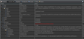

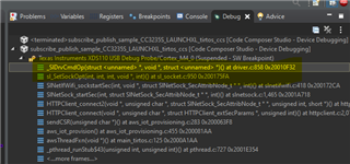

    The entire Chain of failure is this:
    HTTPClient_Connect -> HTTPClient_Connect2 -> SlNetSock_connectURI -> (SlNetSock_create and SlNetSock_Connect succeed) ->
    ret = SlNetSock_startSec(cli->ssock, secAttribs,SLNETSOCK_SEC_START_SECURITY_SESSION_ONLY | SLNETSOCK_SEC_BIND_CONTEXT_ONLY)
     The Arguments that get passed into this function and the variables that get updated are outlined in this screenshot:
    The population of the struct is what fails within this function, but of course we can go deeper into the drivers:
    sockstartSec leads to sl_SetSockOpt ->
    VERIFY_RET_OK(_SlDrvCmdOp((_SlCmdCtrl_t *)&_SlSetSockOptCmdCtrl, &Msg, &CmdExt)); ->
    RetVal = _SlDrvMsgWrite(pCmdCtrl, pCmdExt, pTxRxDescBuff);

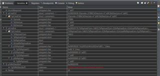

    This function is called more than a few times to send messages to the NWP. In this particular case, when failure occurs, the arguments are:
    You can see that the payload is my PRIVATE_KEY and the length is 54,653 . I will say they payload length changed a bit when you educated me on where the private key was located. So changing the private key location did change the payload length a little bit.
    Inside the _SlDrvMsgWrite function ->
     /* Only 1 payload supplied (Payload1) so just align to 4 bytes and send it */
     NWP_IF_WRITE_CHECK(g_pCB->FD, pCmdExt->pTxPayload1, _SL_PROTOCOL_ALIGN_SIZE(pCmdExt->TxPayload1Len));
    -> When this last function is called, the function attempts to RETURN, and the next immediate thing that happens is the _SlDrvHandleFatalError.
    When this function attempts to return, these are the variables:
    So it seems that the SPI transfer completes, however this is the last thing I can see before the error handler gets called. This very well could be a driver issue. This occurs when I’m transferring the Private Key to the NWP, but it does seem that my private key config has been resolved. Despite this, I’m still having the issue.
    Maybe the NWP is rejecting the payload for some reason? I'm unable to speculate why this message is breaking my program. It could be something under the hood.

    No. That is not correct way. You should changed SDK version at your project properties.
    Jan
  • SDK Version under project properties is showing 5.30. It is inherited from my tirtos_builds_cc32xx_release_ccs project.
    If this is not what you are referring to, could you elaborate on what you mean? A little bit more detail would help eliminate a lot of miscommunication.
    Thank you.
    In case you have changed SDK version inside your TIRTOS project, that this is correct way.
    If your previous project is based on older SDK version than 5.10, you need to change your pre-compilled libraries from *.arm4 to *.a.
    Jan

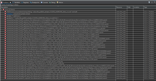

  • I have only ever used 5.20 and now 5.30. I'm not sure how to implement what you are saying, but it sounds like I don't need to know because I have never used below 5.20.
    Also, I deleted my old tirtos project and this one was automatically imported for me. I did confirm it was showing 5.30.
    I still have all these unresolved symbols errors. Is there any good place to start resolving them? I'm not certain what they all have in common or I would start there.
    Thank you.
  • Jacob,
    I could not get the tcpEchoTls example to work. However, I boiled down my issue to the program not creating my security attributes.The httpclient.c function HTTPClient_Connect chose to "Reconnect" to the server instead of "initially connect". I forced the function to "initial connect" (using if(1)), and now I am getting a proper 200 response along with the response body being my original CSR.
    There is definitely something wrong here, and someone needs to look into it, but for now I will just force the creation of the security attributes. It seems that the security attributes need to be created before the Send_CSR function. A NOT NULL object needs to be passed so that it creates the secAttributes.
    In this project, the third argument of HTTPClient_connect is 0. So the secAttributes are never created. Because they are never created, the connection fails. Now if the drivers were sound, and the code was correct, the process would be error-handled correctly. Why the drivers fail is beyond me. There is a deeper problem, but this will at least help people make it work.
    /* Extract security parameters */
        if (1)//exSecParams != NULL)  // NEEDED TO HAPPEN
            retVal = createSecAttribs(exSecParams, &secAttribs);
            if (retVal < 0)
                return (retVal);
            retVal = parseURI(hostName, &port, domainBuff, &intFlags);
            if ((retVal == 0) && (intFlags & ISDOMAIN))
                 * Copy the domain into malloced memory to avoid pointing to the
                 * stack's memory inside secAttribs.
                domainPtr = malloc((strlen(domainBuff) + 1));
                if(!domainPtr)
                    SlNetSock_secAttribDelete(secAttribs);
                    return (SLNETERR_RET_CODE_MALLOC_ERROR);
                memcpy(domainPtr, domainBuff, (strlen(domainBuff) + 1));
                retVal = SlNetSock_secAttribSet(secAttribs, SLNETSOCK_SEC_ATTRIB_DOMAIN_NAME,
                                                domainPtr, strlen(domainPtr) + 1);
                if (retVal < 0)
                    free(domainPtr);
                    return (retVal);
            cli->secAttribs = secAttribs;
            cli->secAttribsAllocated = true;
        else if (cli->secAttribs != NULL)  // WAS HAPPENING
            /* We're attempting to reconnect to a server */ WAS HAPPENING
            secAttribs = cli->secAttribs; // WAS HAPPENING
        retVal = HTTPClient_connect2(client, hostName, secAttribs, flags, NULL);
        if (retVal < 0)
            HTTPClient_disconnect(client);
        return (retVal);
