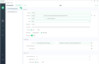

CC3235SF: Unable to specify valid root CA certificate for Google GCP IoT LTS domain
Part Number: CC3235SF
TL;DR -- When using the Google-supplied root CA certificate for its long-term support (LTS) domain MQTT server, the CC3235 refuses to acknowledge that the "GTS LTSR" certificate signed the chain, even when a separate test tool is able to connect successfully.
So, we have a project where we connect to Google GCP IoT using their MQTT endpoint.  If we connect to their regular endpoint (mqtt.googleapis.com:8883) and use the GlobalSign Root CA certificate, we can connect successfully.  Here is an OpenSSL certificate dump when connecting to this endpoint.

Curiously, this dump complains that it was "unable to get local issuer certificate", apparently meaning it was unable to retrieve and dump the root CA certificate.  But if you extract the "GTS LTSX" intermediate certificate (the last one in that dump) and open it, you will see that indeed the "GTS LTSR" root certificate signed it.
And if I double-click to open the GTS LTSR certificate and save it, it has the same "thumbprint" as the "gtsltsr.crt" certificate one can download directly from Google.  Here is that certificate in PEM form:
