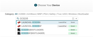

  • Hi JY,
    In Uniflash, did you select LAUNCHXL-CC3235S or CC3235S(BOOTLOADER)? Please select the LaunchPad version if you have not already:
    Can you use the auto-detect feature in Uniflash to ensure you have selected the correct board to use? You should select Development Mode so that you can debutg in CCS.
    Jacob
