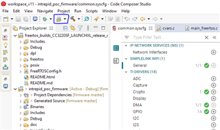

  • Hi Jan,
    I used Sysconfig in CCS to flash the firmware. I made sure to pick the correct project from the dropdown.
    Would it be the linker if it still debugs properly?
    I think the workflow for using Sysconfig in CCS is correct but hopefully from the screenshot above you can tell me if that's true.

  • Hi Luke,
    From image above I am not able confirm if your workflow is correct, but SLI Image programming is under that icon. I think you should check your workflow with SDK example(s).
    Yes. It is possible that you will be able debug via JTAG code which you will not be able executed from SPI flash. This is because JTAG can load directly into RAM or XIP (on-chip execution) flash. But for loading code from SPI flash it need to be build with proper enter point because code is loaded by ROM bootlaoder.
