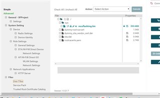

Hi Ti,
       We are facing an issue related to OTA update in out firmware, previously it was working well, but from last few days it's not. log are below.

sdk version : simplelink_cc32xx_sdk_5_20_00_06.
sample example : cloud_ota.
bundle files are below:
otauser.h file
